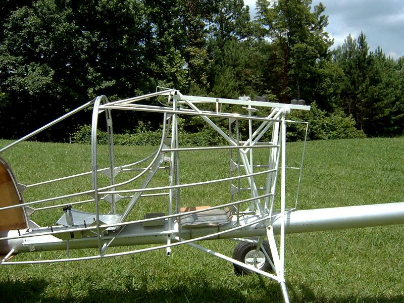

PostPosted: Wed Jan 17, 2007 7:03 pm    Post subject: Second thoughts on welding Kolb structure Reply with quote
So, in the spirit of "one good test beats a thousand well reasoned
opinions", is there anyone out there who has the tailfeathers for
his Kolb done, but not covered? I'm not sure model would make that
much difference, but to be as close as possible, a Fire Star or a FS
2 are very similar in area of the tail feathers of the Cumulus. If
you're near central Kansas, I can bring scales to do the weighing.
Rick

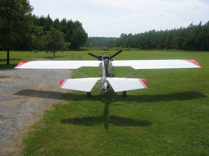

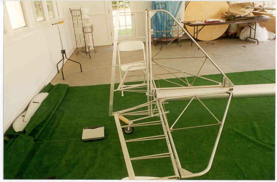

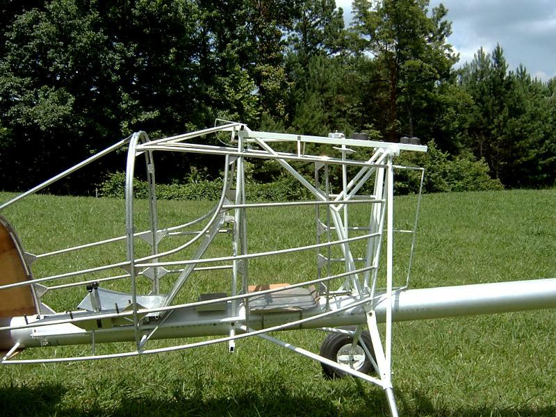

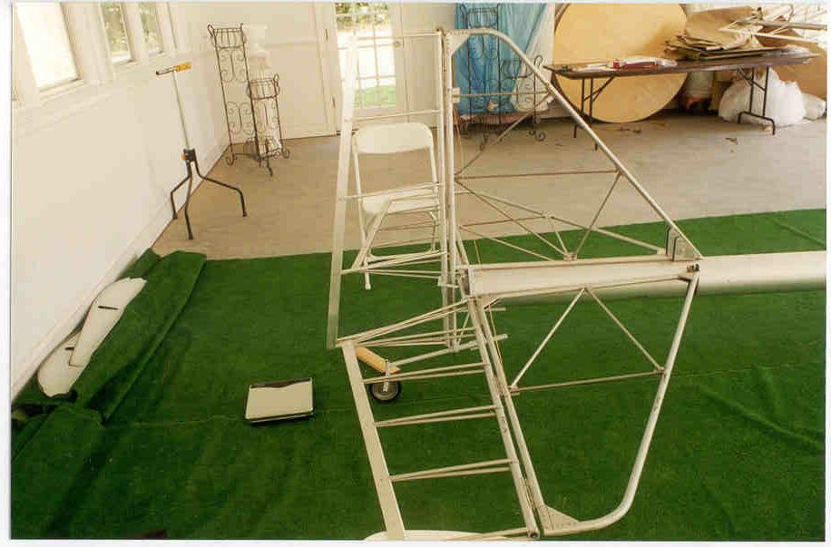

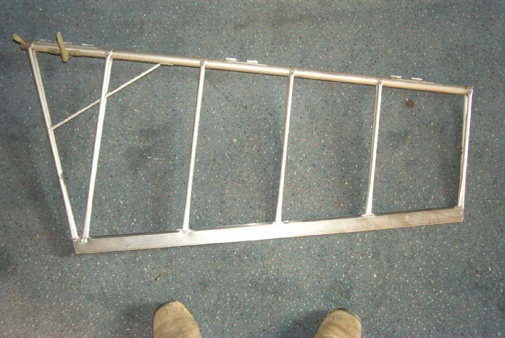

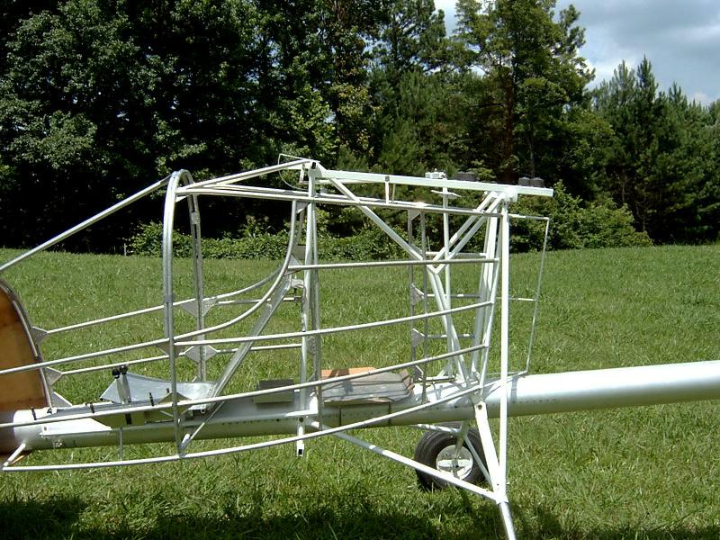

Just some different "mods" we've done on the tail -
down south in Possum country.
 Filesize:  187.73 KB
 Viewed:  298 Time(s)
 Filesize:  124.59 KB
 Viewed:  287 Time(s)
 Filesize:  70.03 KB
 Viewed:  312 Time(s)

Good ideas, and perty nice workmanship, Possum. How has it all worked out
in practise ?? Do not Archive.

possums(at)bellsouth.net
PostPosted: Wed Jan 17, 2007 9:55 pm    Post subject: Second thoughts on welding Kolb structure Reply with quote
worked out in practise ?? Do not Archive.
Larry Bourne

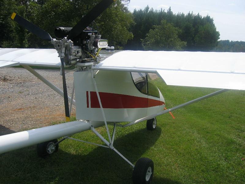

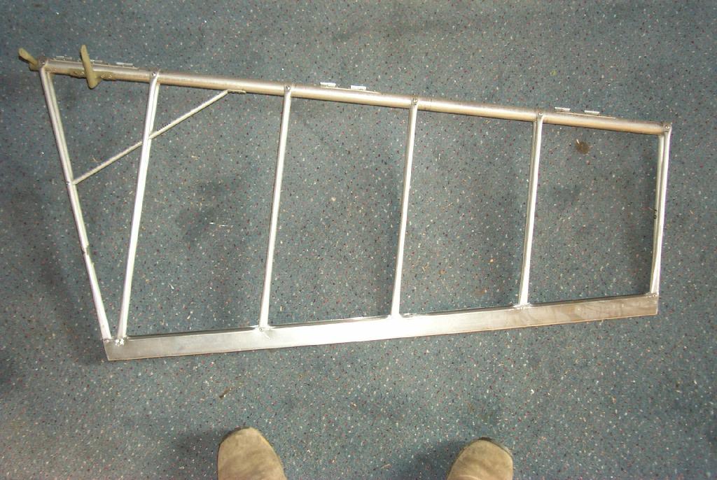

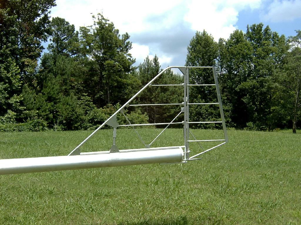

OK so far - but you never know?
 Filesize:  73.82 KB
 Viewed:  290 Time(s)
 Filesize:  77.56 KB
 Viewed:  285 Time(s)
 Filesize:  79.9 KB
 Viewed:  303 Time(s)
 Filesize:  85.92 KB
 Viewed:  310 Time(s)
 Filesize:  131.23 KB
 Viewed:  286 Time(s)

PostPosted: Thu Jan 18, 2007 5:57 am    Post subject: Second thoughts on welding Kolb structure Reply with quote
I like the toe in you've added to the rudder.
