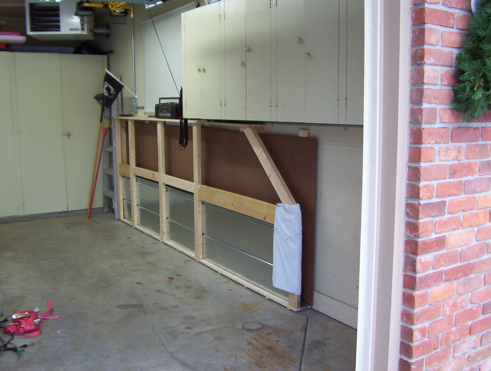

PostPosted: Sun Feb 05, 2006 10:57 am    Post subject: Re: Corrosion Prevention: Alodine and Zinc Chromate Reply with quote
I work for GM in their Prototype Manfacturing Facility Press Room. We get sheet metal in the flat on skids with a cover sheet on top and bottom. Our guys don't use any material with rust (oxidation) when they make the stampings, the cover sheets are often thrown out. It will provide incorrect test results when we crash test or endurance test the structure.
If it was me, I would replace the the oxidized metal and call it a learning experience. You might have some areas of the sheets that can be used, if no oxidation is present. Keep it clean and dry in a rack like this below:
Here is a link with a little more explanation of the rack.
http://www.kitlog.com/users/display_log.php?user=rlendon&project=113&category=1317&log=9945&row=1
Material rack, holds 4' X 12' sheets
 Filesize:  661.63 KB
 Viewed:  829 Time(s)
