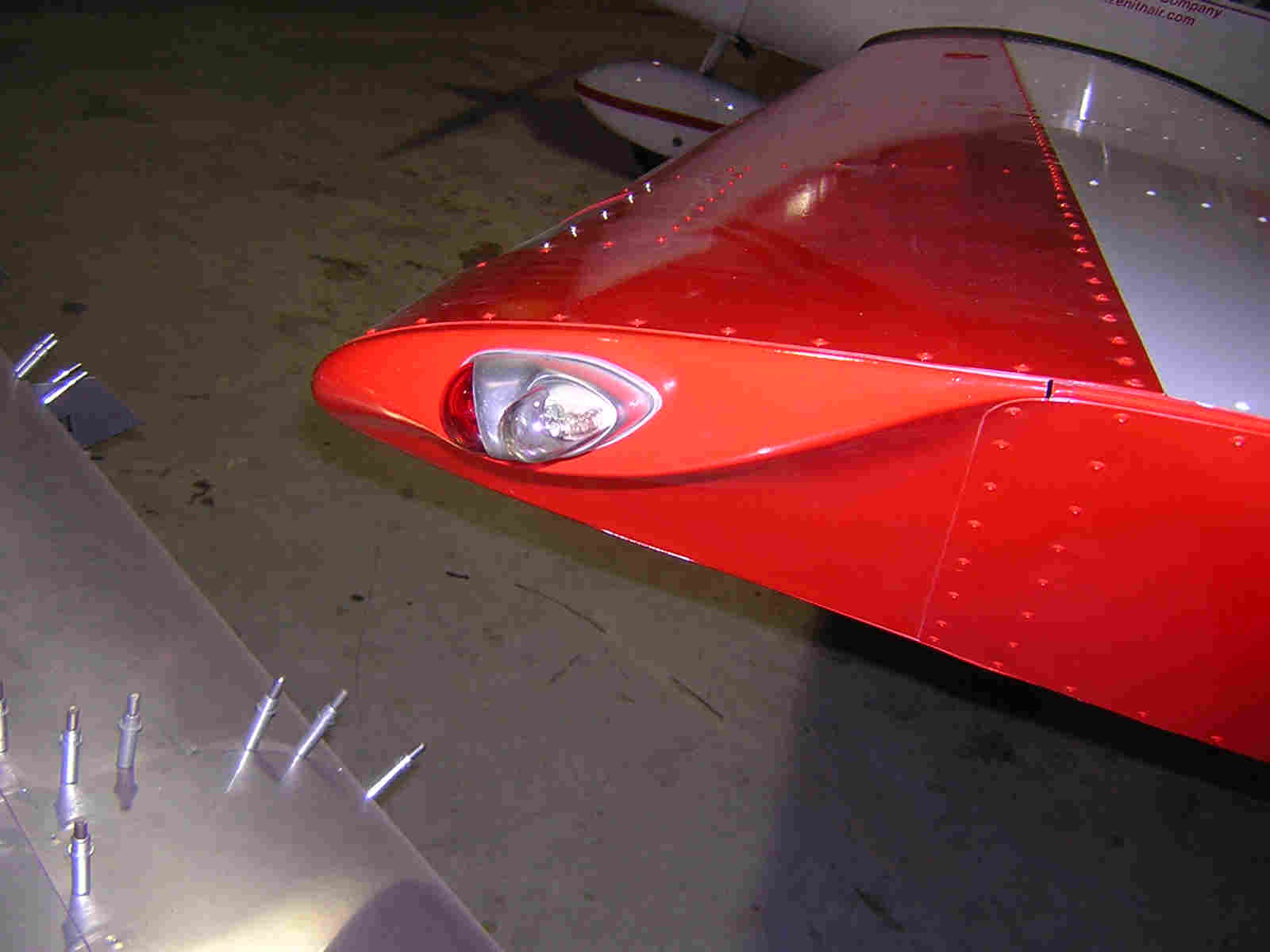

I like the looks of the GS package myself, but I am concerned about visibility from the rear. I am attaching a photo I took at ZAC of the left wing time of the 601XL. The light is attached close to the front of the wing on the fiberglass wing tip. It appears likely that the view of a wing tip light from immediately behind the A/C would be obscured by the wing. Probably, if one got far enough behind, the light could be seen. The question is would it meet the requirements of FAR 23.1385-23.1397.
FAR 23.1389 states, in part:
§ 23.1389 Position light distribution and intensities....
(c) Rear position light installation. A single rear position light may be installed in a position displaced laterally from the plane of symmetry of an airplane if
(1) The axis of the maximum cone of illumination is parallel to the flight path in level flight; and
(2) There is no obstruction aft of the light and between planes 70 degrees to the right and left of the axis of maximum illumination.

It appears to me that 23.1389 would allow wing tip light pairs whose maximum intensity was straight aft with the +-70 deg visibility requirements being supplied by the lights on either side of the plane. However, the real question is, "At what distance behind the A/C must the rear position light be visible?" Are we talking flight distances, which should be at least a few hundred yards, or are we talking taxi distances which could be a few 10's of feet? I don't know the answer, but this question should be answered before one decides to leave off the tail light. I understand that GS may have documented arcs of visibility, but I believe that such arcs must be A/C dependent.

PostPosted: Sat Jan 13, 2007 12:08 pm    Post subject: Zenith-List Digest: 16 Msgs - 01/11/07 Reply with quote
If the plastic wingtips are mounted correctly the little flat area is pretty much alighned with the long axis of the airplane. A light which protrudes from that flat area will definitely be visible within 1200 feet of the front and rear of the plane as required by the FAA and described on the Whelen site. That ought to take care of it but redundancy is always an option to an experimental builder.

PostPosted: Sat Jan 13, 2007 1:22 pm    Post subject: Zenith-List Digest: 16 Msgs - 01/11/07 Reply with quote
If 1200 ft is good enough for Whelan, it is good enough for me. The GS package looks like the best way to go. Thank you for the input.
