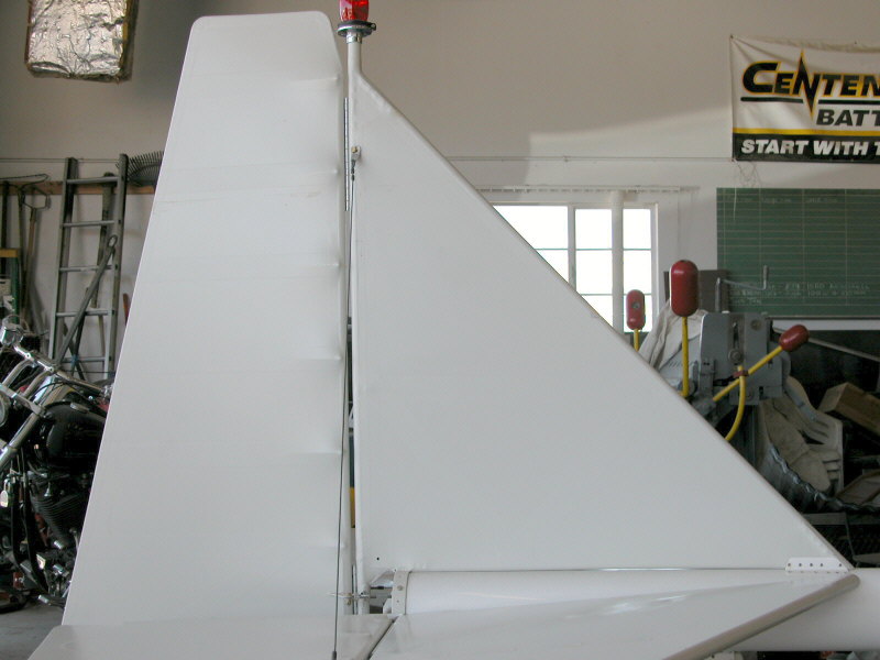

I have a single strobe light I need to mount on my Firefly. Is there a "best" or standard place to put it for maximum visibility to other traffic?

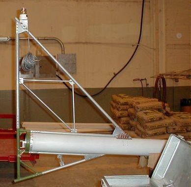

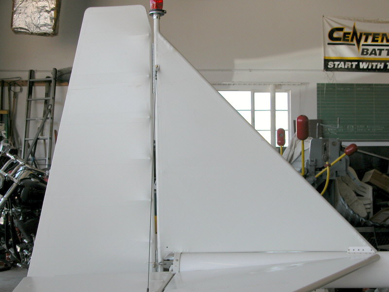

Here's where I stuck mine....I only have one.
Gotta Fly...
Mike in MN

FWIW I think top of the rudder is best for a single strobe (not too
heavy; watch balance) You'll be most visible to traffic above you,
should be good for any low-flying craft. If you can have two, put
them on wingtips

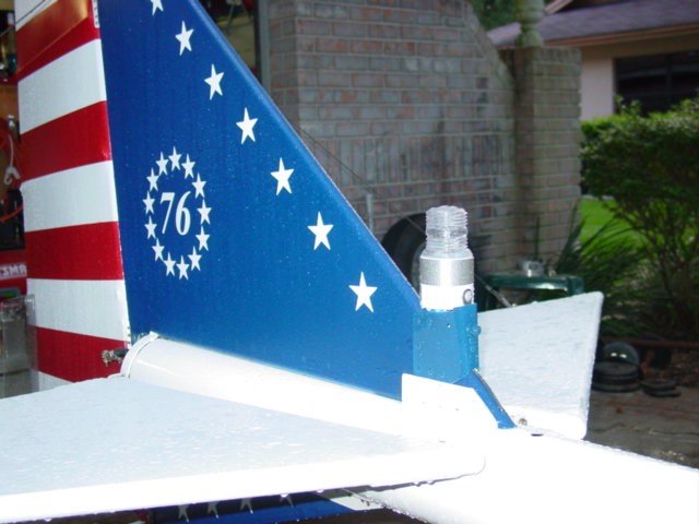

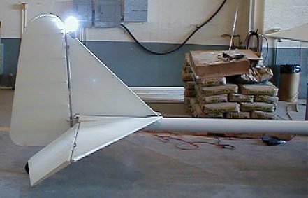

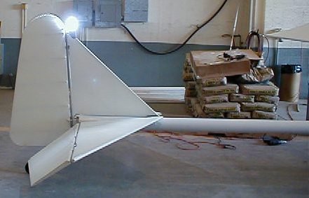

Here's another mounting possibility...This is a Kuntzleman SC-103.
Quiet Beauford
FF #076

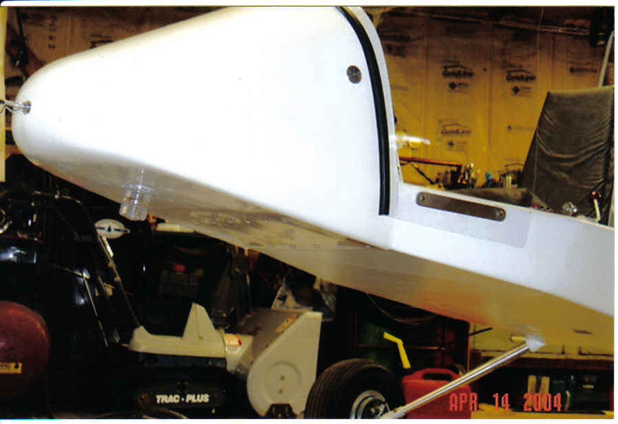

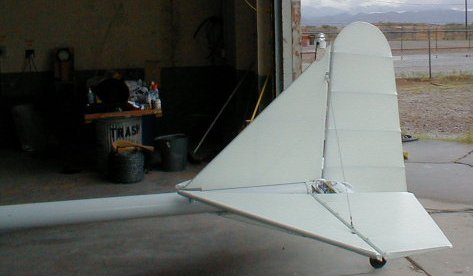

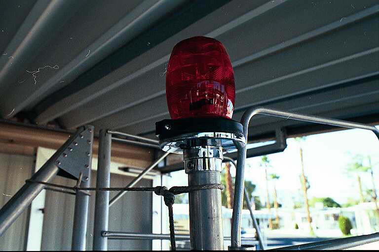

Here's another idea - this one on a Mk III. The red strobe is from Aircraft
Spruce, the chrome mount is a shower pipe cover from Ace Hardware.
Lar.

PostPosted: Tue Jan 09, 2007 7:45 am    Post subject: Re: Where to mount a strobe Reply with quote
Thanks for everybody's input. The pictures were very helpful.

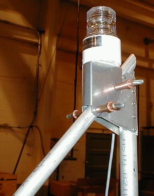

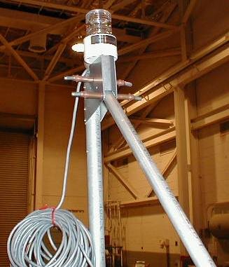

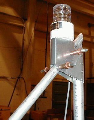

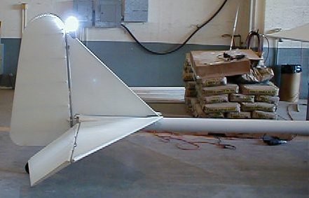

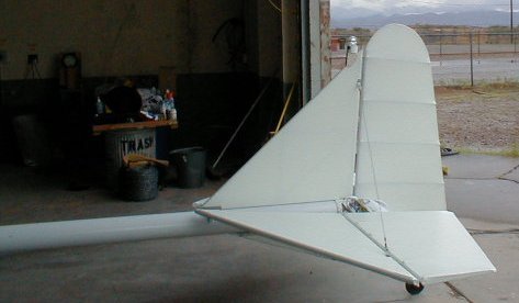

Here is how I mounted my Kuntzleman strobe.
