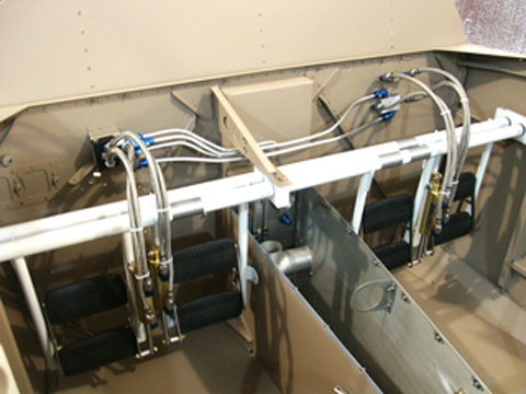

RV-10 Listers,
I have just completed my newly designed Brake Pedals and Teflon-cored braided stainless steel brake line system. I am considering offering this package up for sale.
Brake Pedals
I designed the brake pedals to eliminate a problem a number of RV pilots have shared with me. When coming in for a landing with a crosswind it is very easy to be applying the brake simultaneously with moderate rudder inputs. This leads to higher tire wear due to the application of brake at touchdown. In extreme cases the aircraft could veer unexpectedly upon touchdown.
My design allows room for your toe and provides a separate pedal tread for rudder only application. When you are applying rudder the brake pedal is depressed OFF. You simply move your foot upward, placing your toe on the upper tread and the heal of your foot on the lower tread to apply the brakes.
The brake pedal chassis are constructed from stainless steel so that there will be no di-electric issues in an area that sees moisture. The tabs are TIG welded and the assembly is screwed together using stainless steel hardware. The pedal treads are high quality rubber units that come from an automotive supplier.
I have designed these brake pedals to exactly fit in place of Van's pedals and they align at the top when the bottom of the rudder hoops are aligned at the bottom. 3 bolts out, 3 bolts in. All you have to do is place the appropriate washers for proper spacing.

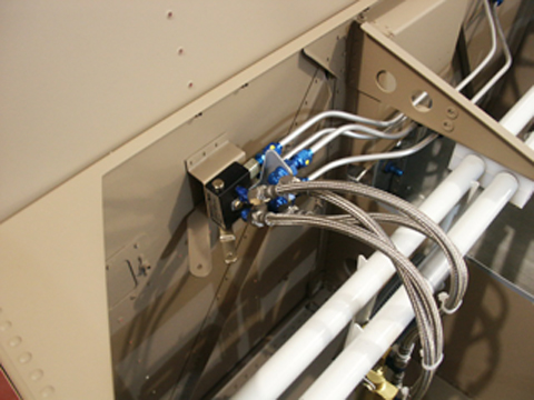

Teflon-cored Braided Stainless Steel Brake Line System
I also developed an upgrade to the Plastic brake line system that Vans provides with the kit. I have replaced the entire brake line system from the reservoir to the Matco Parking brake interface with the aluminium lines on the firewall.
In this installation I have inverted the Matco master cylinders. This allows for a much neater installation and less clutter between your feet.
I developed this system for a couple of reasons. First, I heard that there were some leakage issues with the plastic lines as well as some sponginess over time that has been attributed to the rubber lined braided hoses that Van's supplies.
Secondly, there is aesthetics. I couldn't get over the fact that I am building an aircraft valued over $200,000 that has the same brake lines that are supplied with many ultralight kits. The footwell looks much more professional and much less cluttered.
There are 3 photos below showing the entire system installed in my RV-10. I anticipate that the brake pedals are going to sell for $175.00 for one side and $300.00 for both sides. I have yet to receive the total cost of components for the brake lines so I haven't set the price for them.
I am putting this out to the list to gauge interest. I have most of the pieces of the puzzle in place to begin selling them. I just need to hear from you builders as to whether there is interest.

Dave-I’m interested but the pictures don’t show details very well. Do you have any others that show details better?

I put the full size photos on our website at:
www.cleavelandtool.com/filecab/brakes.htm

Dave
I am interested in your pedal design and the break line plumbing work. Does Matco advise and approve the inverted master cylinders? Is there a greater chance for leakage? Have you considered the weight change from the original design? Questions, questions, I know. Thanks for putting your effort into this design change. I have not liked the rudder pedal design from the beginning and agree with you 100% that it needs improvement.
