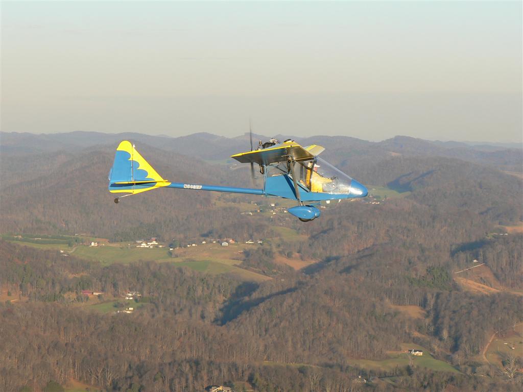

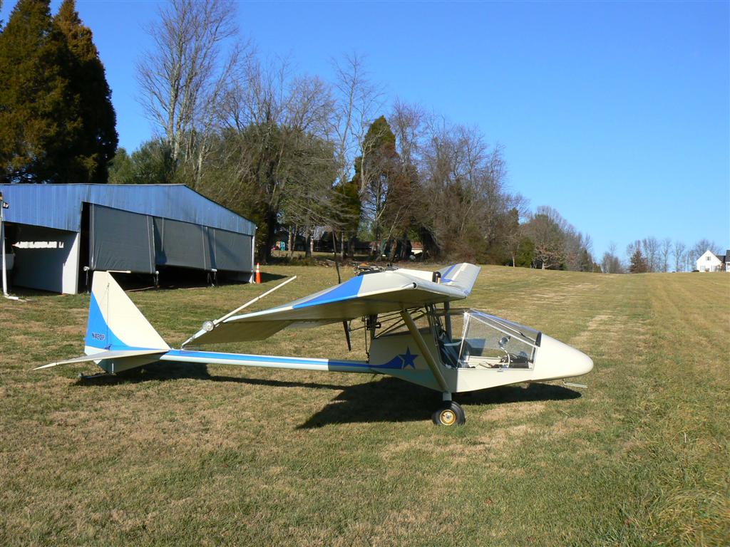

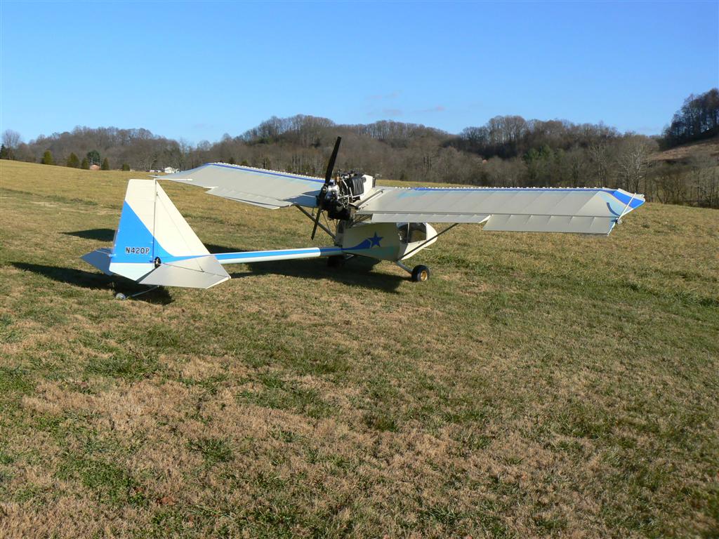

Since the FSII flew hands off so well with a bunch of dihedral, decided to try it on the MKIII and see if it could also be made to fly hands off. You can see from the pictures how much dihedral is in the FSII, and how much is in the MKIII, but the results were not at all alike. Could not come up with a combination of trim or throttle settings that would enable hands off flight. It was better than before, but just barely, it was still impossible to pick up a low wing with rudder. There was a small amount of turbulence, but very small. Perhaps if I had a passenger so that it was balanced on each side, and the air was glass smooth, or maybe if I had a full fuselage that ran up to the base of the wing - who knows?
Anyway, my initial tests show that dihedral is of no apparent value on this MKIII, your results may vary. None of the other flight characteristics seemed any different. Will probably put it back like it was. The gap seal fits better that way...
