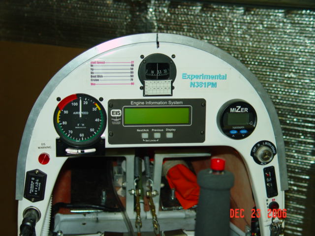

Hey Guys,
I started working on my Full Enclosure today....
I'm off work til next year ( use it or lose it )
Anyway , out in the garage using my NEW Tig machine to weld the
aluminum angle contraption.....I had a little over 400lbs of Argon , so I
figured it would get me over these next 3 days....
I got most of the nose cone piece finished....I was going to add a little
weld to radius a corner....Weld was coming out dirty......What the......
Checked my gas......said 400lbs......Hit the button.......Nothin
Ran out gas , seems the flow meter gauge that came with the Tig
machine is a little on the cheap side.....
I've got a few pictures to share.....
"My" full enclosure is going to be done in sections.....That way pieces can
be changed easy and cheaper than replacing the whole thing...
in the pictures is my Front mounting bracket for the main wind screen...
It'll have two main tubes welded to it , and doors will hinge off of them,
or Fly without the doors...
Gotta Fly...

How are you forming your curved surfaces? They look beautiful.
jerb
At 06:38 PM 12/23/2006, you wrote:
| Back to top |
planecrazzzy Guest
Posted: Sun Dec 24, 2006 3:07 am Post subject: Re: Full enclosure |
Hi Jerb,
Thanks for the complement !
The Main shape was done buy taking a piece of Aluminum "Channel"
( square - not tapered flanges )
I put it through a "Roller" at work ....curve it alittle , lower the roller,
do it again until I got the radius that was close..... From there it was a
matter of hitting it with a deadblow hammer against wood , to get the
shape even closer.
After I got it's shape as close as I could , I then cut off one of the
flanges....and used the deadblow / wood to fit even closer....
Trying to do this with angle from the start is a mess .....
The channel really helped....
After the basic shape was done , I used my TIG to do the detailed wrap
around for bolting it in the existing holes....
I'll probly add two bolts around 10 & 2 O'clock
(Stainless bolts because of the Compass)
. Gotta Fly...
