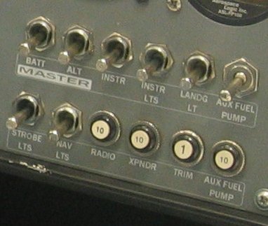

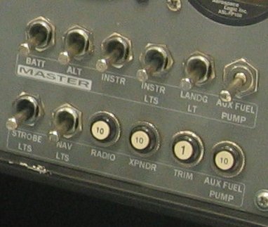

PostPosted: Thu Dec 21, 2006 8:59 am    Post subject: Re: Labels and More Reply with quote
These were made with a ~$120 P-Touch labeller, and the included software on a PC, which was connected to the P-Touch.
Bill Mileski
