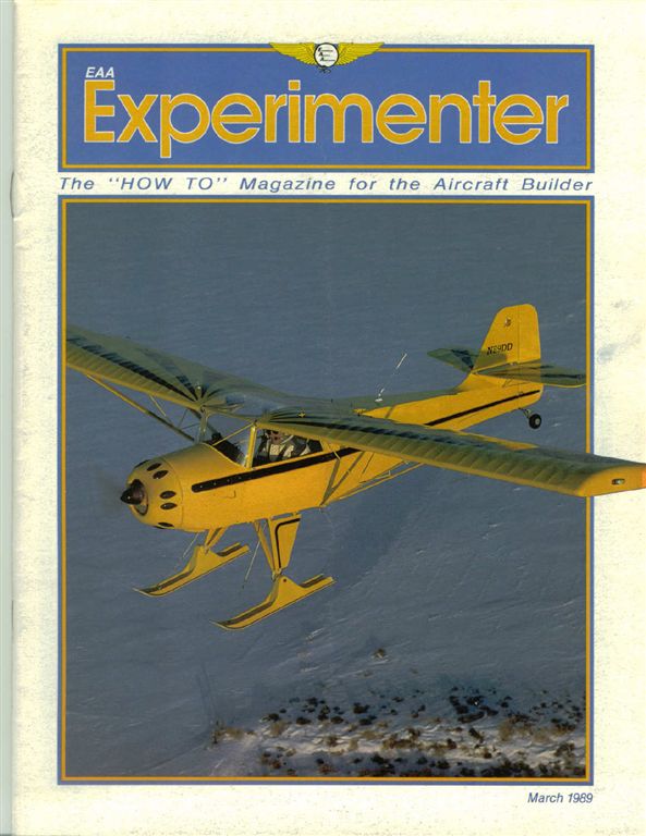

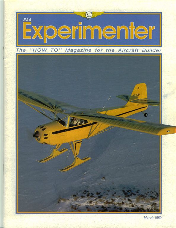

As a side note, does anyone see anything wrong with the airplane on the
cover? Look close, as there is an obvious problem with it (experts usually
laugh when they see this picture).

Looks like a asymmetrical wing strut modification. Smile Not a popular
option.

I don't see any aft shock cords on the skis.

looks like a photochop to me...
The photo looks like the plane is in the air, but the skis are not in the correct position for flying... the ski tips are low and the rear limiter cables are sagging suggesting that it is sitting on the ground.

I have a couple of questions... The answer to one depends on the other.
Where did they ever get a flash strong enough to light the plane from the
bottom .....or was he flying inverted, possibly vertical ???

BINGO!! Leni wins the prize! (ahem,,, we'll be mailing that out right
away....just send $54.95 to cover the shipping costs Leni) (chuckle)
Ski tips should always be up about 15 degrees in flight. Obviously in this
case they didn't understand how to rig ski cabling, as the front cable needs
to much shorter. In flight the rear cable should be taught, and the spring
bungee on the front taking up the slack in the loose front cables that is
needed to let the ski sit level on the ground when the tail is down. In
other words, the skis as they are could easily catch a tip when landing in
anything less than three point landing. Catching a tip while landing could
be disastrous. Rigging skis is a very important thing to get right as a
ski can also make for a large control surface (besides catching a tip
because it is rigged down too far). Imagine if one ski cable bungee broke,
so one ski was up 15 degrees, and the other was down say 40 degrees. I've
never flown one like that, but you had better hope you have enough control
authority from the rest of the control surfaces to stop the large downward
spiral dive you are otherwise going to enter. Don't let me scare you about
flying with skis now. Just make sure they are rigged right. This factory
demonstrator made a very good example of how to NEVER rig a ski on an
aircraft.
It was the things like this that used to cause so much riff between Avid and
Kitfox. I remember the Avid clan having a good laugh over that one
(remember, Avid was flying skis on their planes before Kitfox was even in
business. So all Kitfox would have had to do back then was to look at
theirs to get it right...) I don't mean to start any hot discussions about
which is airplane is better, because they are both marvelous airplanes, and
the Kitfox in particular has evolved rather nicely (I know I have both).
But the little things like this make it very obvious which company had the
real designer.

I think it was the snow acting as the worlds best flash reflector...

Also, the front should have a limiter cable incase the bungee breaks for the very purpose of keeping the skis from rolling into a excessive nose down attitude. I have had it happen on RC models. Last year I had my 1/6th scale Beaver (22# and an 8' wing span) on Skis and caught the tip on takeoff. I had limiter calbes, but it still alowed the ski to rotate to far. It was a bit of a handful when I tried to slow it down for landing.. as the rudder lost effectiveness at low speeds. I was able to go into the programing in the air and go to 140% throw on the rudder and then made a safe landing. I would not want to do it a real plane..
Exactly! If my skis were like that in the air, I'd have a serious
problem.

So how did they get the plane lit from the bottom? Smile

Disregard my last post.... The picture looked like something manipulated.
The bungees on the tips of the skis seemed stretched which made me think the
picture was actually taken on the ground. Note the alignment of the ski
with the tail wheel.
My best guess now is they rigged the skis with the tail down on the hangar
floor....
BTW I have a set of those composite skis. The previous owner of my plane
even made a set or removable rear tips so the plane can easily be towed
backwards by a ski-doo. I was warned to always remove the rear tips before
flight.

Those pics just show that they wer rigged with too long of cable on front
and the airflow is pushing them down.
Not a good thing at all.

The shadows look acceptable to me, Noel...it looks like a low winter
sun shot to me. Look at the shadows on the ground...they are all
being caused by the same apparent light source. If not the low sun,
then probably a strobe or single light source of some sort.

NO they are not to long when you are on the ground they have to be in that
angle . Supposed to have a strong enough bungy on the front to pull them up
when in flight .

John ,
When on the ground , my bungees are stretched.
When in the air the bugee pulls the ski until the safety cable on rear
become tight unless of course the front is too long which makes it loose and
the ariflow pushes the tip down.
You can see mine here in the video from 10 days ago
http://www.cfisher.com/kitfox/
And my rear safety cable could afford to be about 1 inch longer.
If you need some pics, just let me know and I will post them.

UHHHHH Dave
when sitting flat on ground with taildragger your skis should be straight
out level in front of you on the ground. Look at the pic that is how the ski
is flying . You then install your front safety cables to linit them to this
spot . now you lift the tail and to until the plane is in level flight mode
. and then add 2-3 inches up on tail . now place your rear limit safety
cables . now put your bungees on and make shure they are strong enough to
pull the skis up in the front in flight . I have done MANNNNNNNY instals on
aircraft . If you read my last post slowly you will see this is what is said
in much shorter post .

UHHHHH Dave
cables to linit them to this ............
spot .
