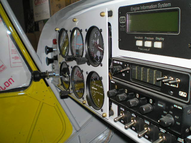

Here is a couple of pictures of the insturment shock mounts I used from Aircraft Spruce. Three on top and four on the bottom. The sub panel sticks out about 3/8" from the base panel.

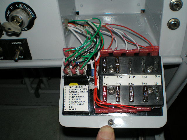

The other picture is the fuse block and common ground block I have mounted on the inside of the glove box door.
