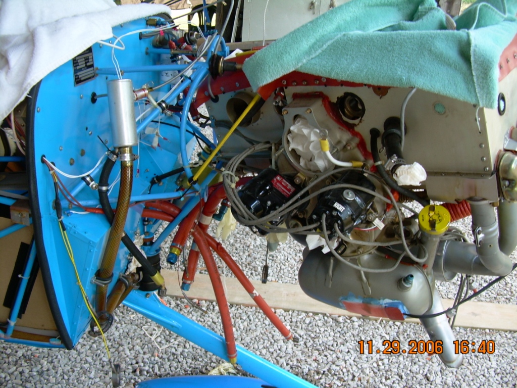

I pulled the engine today for access to the alternator. There was one nut (top) that was almost impossible to remove (ended up removing the starter for easier access) on the alternator. The drive gear on the end of the alternator shaft rotates freely! I have emailed Drake Air (also left them a voice mail...have heard back from them) regarding their rebuilt units. This does not look like a field serviceable part as shown in the Aircraft spruce book (doesn't look the same)! I would welcome any contact names for parts suppliers/rebuilders that would carry this part. I also realized today that I need to replace the motor mount bushings!
Thanks again!

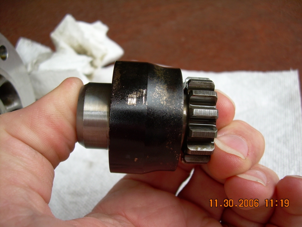

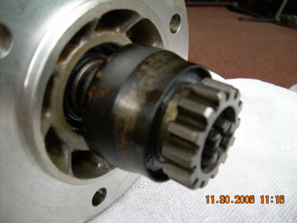

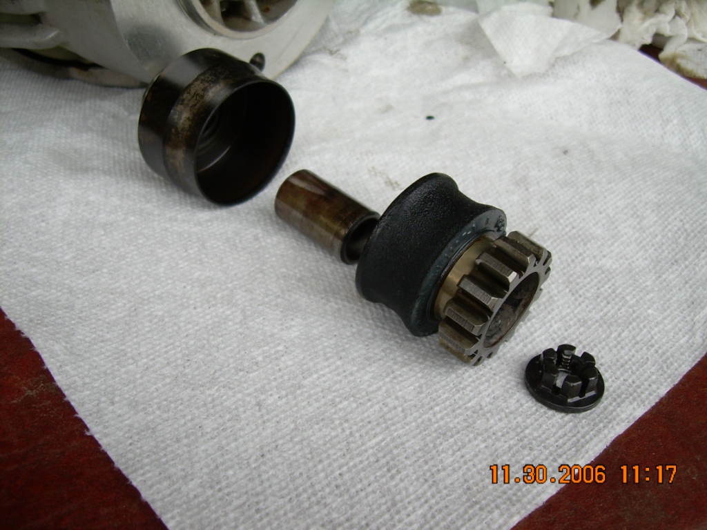

I wanted to bring closure to this issue. Please accept my sincere appreciation to all those that provided a wealth of information. The elastomeric puck was the failed part. I sent Drake Air my old part so it could be rebuilt. They charge $450 for this service. Aircraft Spruce does NOT carry this part. They carry the rebuild parts for a different drive coupling. I have attached some pictures showing the coupling and the engine removal. Again, Thanks to everyone for your help and support.
Travis

The past 254 hours have been great...until yesterday. My alternator coupling failed...AGAIN! I had purchased a rebuilt unit from Drake Air (as noted above in this thread). $450 versus $1,600 from TCM for a new one.
Is there any reason this part should fail so soon? Oil, hours, temps, alternator load, how the load is applied, etc?
I emailed Drake Air this morning and was inquiring as to why their part failed...prematurely...in my opinion!
I have to pull my engine to remove the alternator. ...insult to injury!
Again...I welcome input from the forum!
