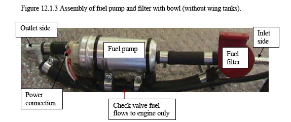

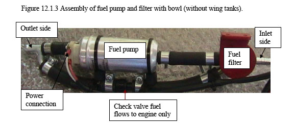

Thom Riddle
Posts: 1597
PostPosted: Wed Nov 29, 2006 6:03 am    Post subject: Re: Facet pump thread sealer Reply with quote
Parallel vs. Series Fuel Pump Installation
I prefer the aux. fuel pump to plumbed in parallel. However, our
Allegro has the pump plumbed in series and we've had no problems in 450
hours use. The pump used in this installation does not have its own
check valve so that is not an issue. Instead it has a separate check
valve plumbed in parallel to the aux. pump. The gascolater is upstream
and has two outlets, one going to the aux. pump and one going to the
parallel check valve. Attached is a .jpeg from the manual.
Allegro aux fuel pump installation
