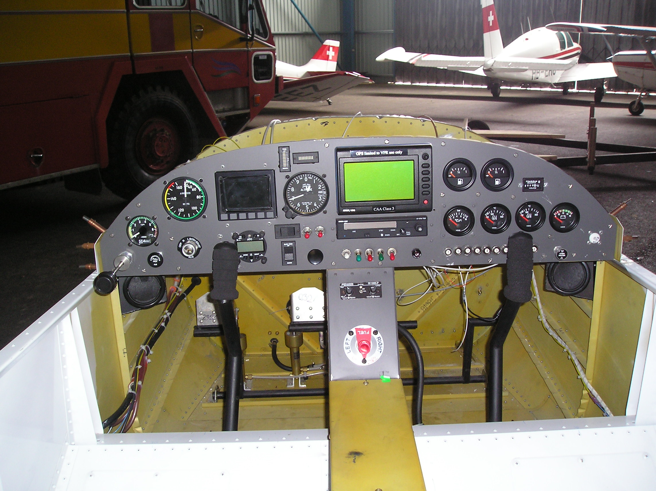

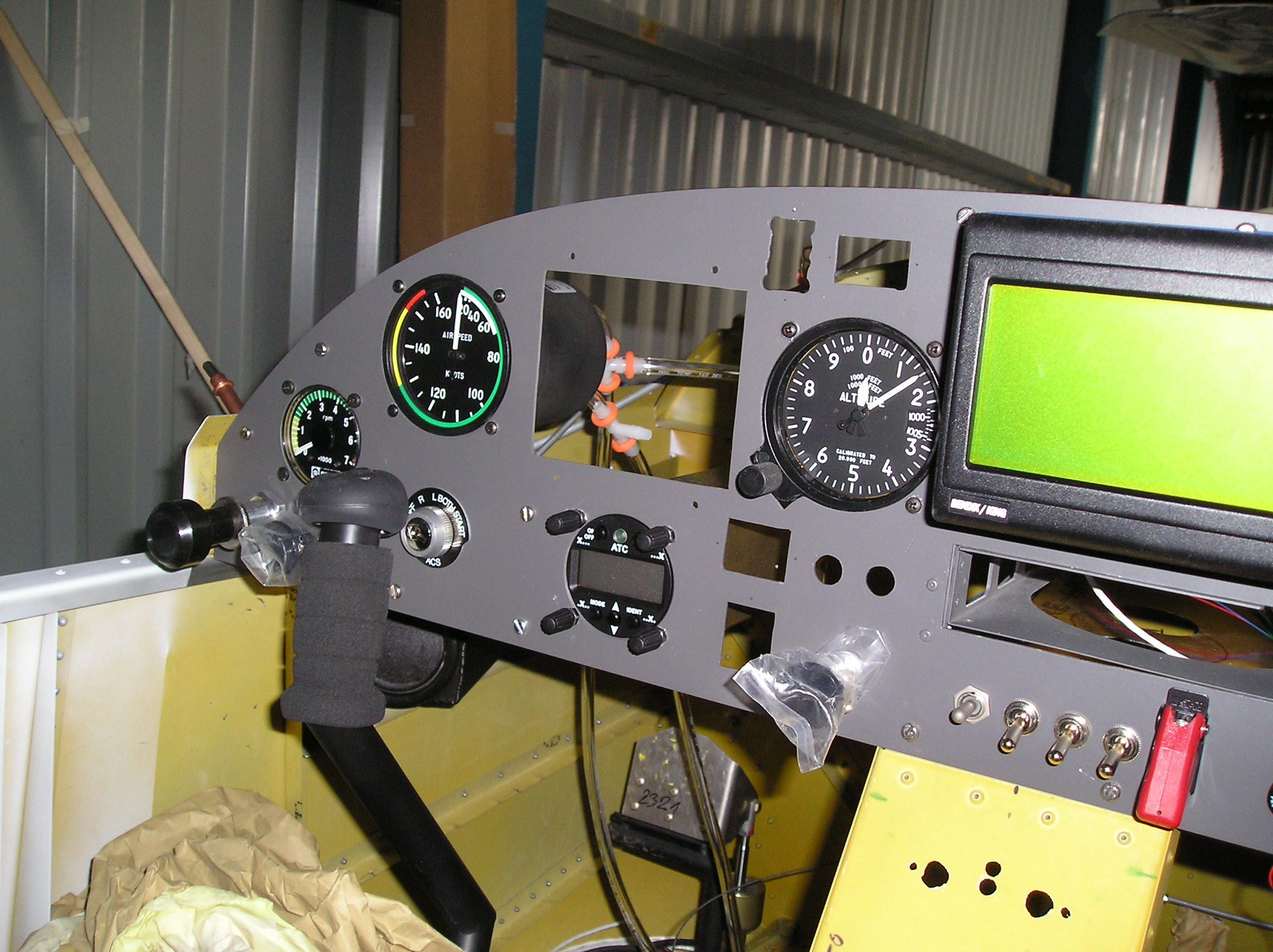

PostPosted: Sat Jan 28, 2006 3:42 am    Post subject: Re: Dynon Help please Reply with quote
These are a couple of photos of my Dynon D10A, before and after installation in my XL. I used the flush mounting plate and rivetted it onto the panel (the grounding connection is good and I don't plan on removing the mounting plate, although it'd just be a case of drilling the rivets out if I do).
Still to see whether I've managed to line up the angles of the EFIS with the remote compass module accurately though.... Rolling Eyes
Andrew
