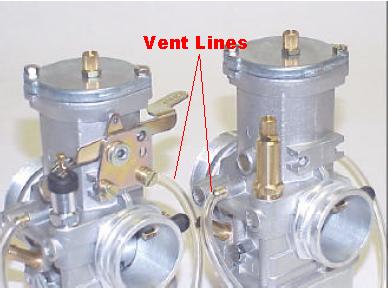

Might want to make sure the "vent lines" aren't clogged up.
If it's a single carb, it won't start if the the holes in the bottom
of theses little tubes are clogged.
