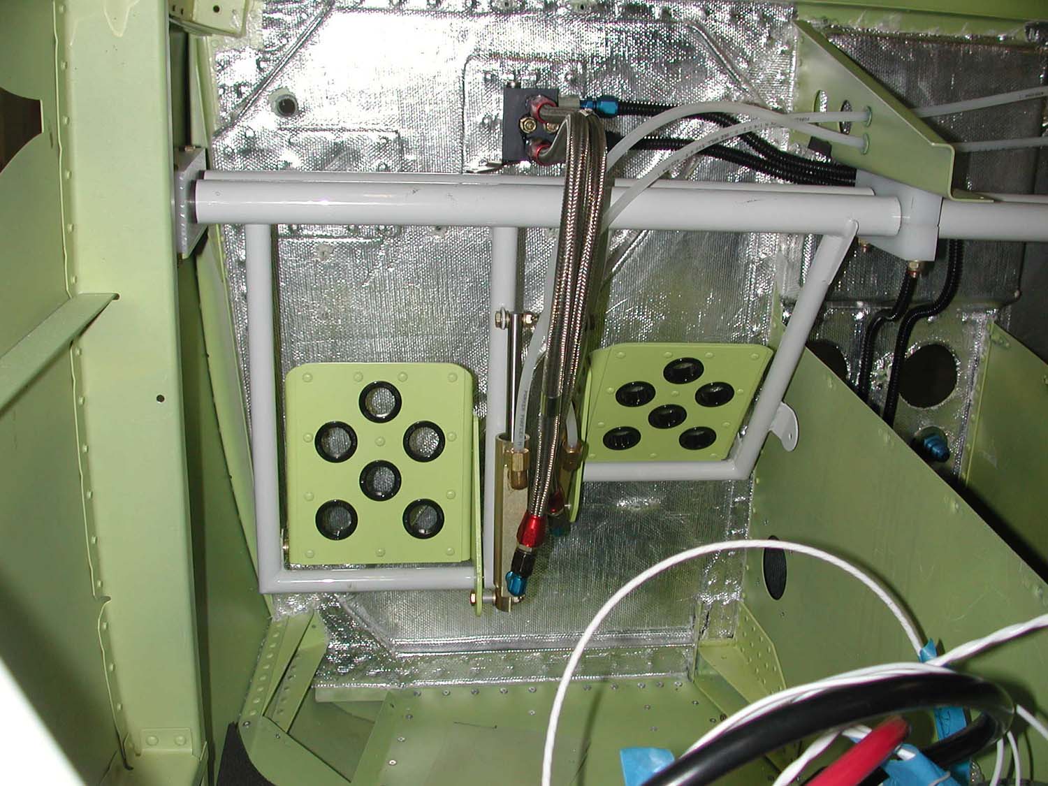

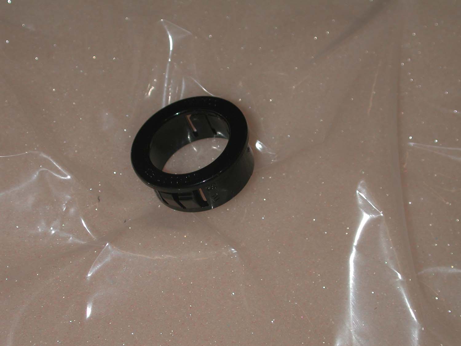

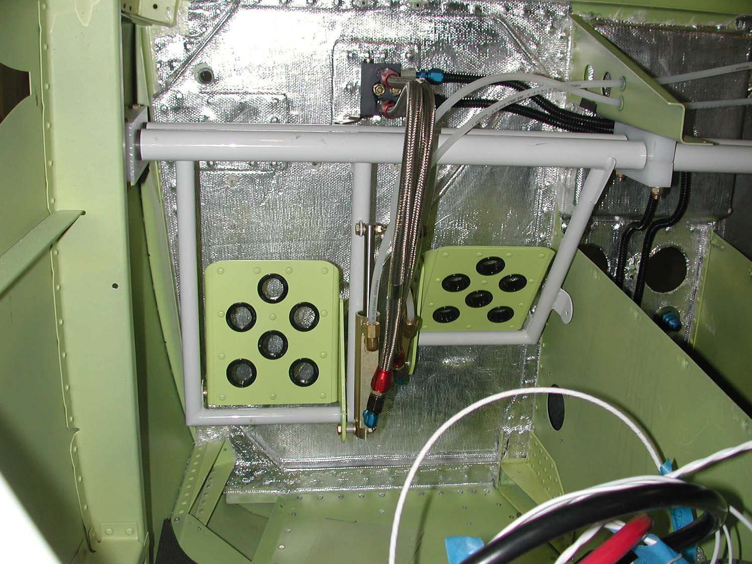

Here some tip to protect the paint from the shoes,I just found a 1" plastic bushing fit perfect in the ligth holes , and a 1 - 1/4 " fit perfect the holes at the vertical frames next to the spars .
