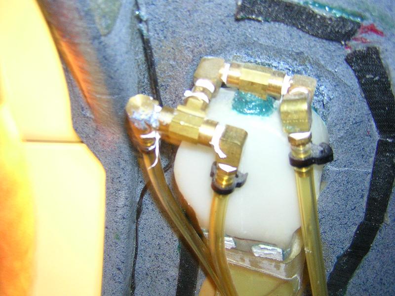

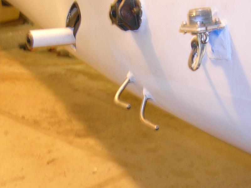

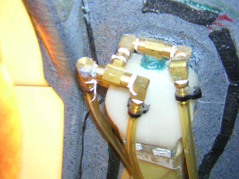

PostPosted: Sat Oct 28, 2006 3:55 am    Post subject: Fuel vent mods Reply with quote
See attached
Steve Hagar
hagargs(at)earthlink.net (hagargs(at)earthlink.net)
 Filesize:  43.35 KB
 Viewed:  325 Time(s)
 Filesize:  82.53 KB
 Viewed:  309 Time(s)
