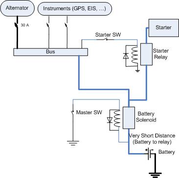

I have attached a picture of what I plan to do to wire my battery power in my 701. This is kind of the way that my Cessna is wired. Is this similar to what others are doing?
Specifically- is the battery relay required? It seems like a good idea.
My battery is behind the seat (where ZAC recommends) and I plan to put the solenoid there too.
I only have the built in alternator in the Rotax, so no additional alternator (30A max).
This plane will only be used for day, VFR, ground always in sight flying. So I'm not too worried if all of my electrical fails. I'm not going to worry about two-point failures (electrical and coolant for example).
Do any of you see any problems with this setup?

PostPosted: Sun Oct 29, 2006 2:43 pm    Post subject: Basic Battery Wiring Reply with quote
Doug,
FWIW, a couple of things to think about in reference to your "wiring
diagram". Remember this is a Rotax alternator system with a yellow output
wire and ( ? don't have the other color marked on my diagram ) ? output wire
going to the "G" terminals of the Rotax supplied Regulator. This is per the
suggested electrical system wiring diagram I received with my kit from ZAC.
This is probably different than a Cessna or Piper which uses a different
regulator. I've designed the electrical systems ( all basic 12 volt DC )
systems for several aircraft including a couple of my own including my
current Rotax 912UL powered 601HD. They have all worked well with one
exception which I will discuss later.
Let me suggest a few items for your consideration based on the diagram you
provided:
1) Don't have your starter wire - which goes from the Batt. to the heavy
contacts of the Starter Relay - go through the Batt. Sol. The starter draws
a heavy current. I would consider having the heavy Starter wire come
straight off the "+" terminal of the Batt to the Starter Relay then on to
the starter.
2) Since the Alt built into the Rotax puts out about 14 amps max. ( as I've
been told ) I don't think you need a 30 Amp main. ZAC only provided a 15 AMP
breaker with my kit and that is what I've used for 10 years and 532 hours
with no problem. Also put the Main ( 15 AMP ) breaker between the Batt Sol
and the Main Buss.
3) Have the Rotax Regulator output ( it is the B+ terminal on the
regulator ) go to the "+" terminal of the battery. This way your onboars
aircraft systems draw from the Battery via the Buss and the Alternator
charges the Battery. There is another thing that the Rotax diagram does - a
short jumper goes from the "R" terminal of the regulator to the B+ terminal
of the Regulator. Also, I was advised to put a load on the "L" ( lighting
coil as Rotax calls it ) to make the regulator work correctly when there is
no other load. They stated that you can use a light bulb or do as I did and
put a 48 OHM load between the "L" terminal and the Main Buss. It has also
worked fine for all these years.
Now for that one glitch I had. When I first put the plane in service, and
didn't run it for a week or so, my battery would be very weak. I thought I
had a bad battery. It turns out there was a flaw in the ZAC wiring diagram.
The wire from the "C" terminal of the regulator orignally went from the "C"
terminal to Battery side of the Batt. Sol. This caused ( because of the
internal wiring of the regulator ) to put a 30 to 50 milliamp continuois
drain on the Batt. What I didn't pay enough attention to was that there were
two different ZAC wiring diagrams. A fellow in Austrailia discovered the
problem on his airplane and put the word out and Jim Weston - a fellow 601
builder - told me about it. Guess what one of the differences was? the
second diagram called for routing the "C" terminal wire to the other side of
the Batt. Sol. So that the connection to the Batt. was only made when the
master is on. I rewired it and am still using ( this is a true statment -
honest ) the same Concord GR-25 Battery which is almost 11 years old and
still starts my 912 fine. That is ALL I use it for so I don't worry about it
failing in flight. As you say day VFR only with full ground contact. That's
my kind of flying. I have all the ratings but I don't use them in this
airplane!
If you don't have a ZAC supplied Rotax 912 ststem wiring diagram, I suggest
you ask them for one. Good luck with your electrons.

PostPosted: Sun Oct 29, 2006 3:13 pm    Post subject: Basic Battery Wiring Reply with quote
Hi Doug,
I am curious why you consider coolant failure in the same sentence as
electrical failure. It seems to me that coolant failure is fatal and
you must land immediately after turning off the engine. Electrical
failure is not much trouble at all so long as you can navigate your
way to a suitable airport.
Paul
XL fuselage
for example).

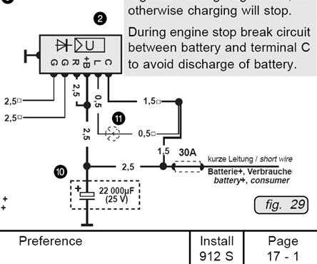

Jim:
[ I noticed an error in my drawing shortly after I posted it. I don't want the starter relay to be powered from the avionics bus, since I want to be able to have the avionics powered off when I crank/shutdown the engine. ]
Attached is the wiring diagram from the Rotax manual that came with my engine. It shows a 30 A fuse. I shouldn't be using any where near that much for my few instruments so I'll go with your suggestion of a 15A. The Rotax manual says that the alternator will put out 28A max.
If I don't have the starter go through the master relay, then the engine can be cranked even though the master switch is off. This seems too dangerous to have the starter switch hot even with the master in the off position.
If I connect the alternator to the battery, and the instrument bus to the battery, then how do I disconnect the alternator from the bus so that everything is powered off of only the battery in the event the alternator malfunctions? Don't I need several switches/circuit breakers? I need to (a) isolate the alternator (alternator breaker/switch), (b) remove power from all of the avionics while I crank & shutdown the engine (avionics master switch), and (c) I need a way to turn everything off (the master).
part of page from Rotax 912S Install Manual

PostPosted: Sun Oct 29, 2006 4:57 pm    Post subject: Basic Battery Wiring Reply with quote
Run the starter directly from the battery through the starter's contactor
but power the coil in the contactor from the switched buss. So the starter
is fed directly but the contactor can't close unless the master is on.
-- Craig
doug kandle
Posts: 33
Location: Boise ID
PostPosted: Sun Oct 29, 2006 6:08 pm    Post subject: Re: Basic Battery Wiring Reply with quote
-- Craig
Craig:
My battery is behind my seat, 6 feet or so aft of the firewall. I don't want any uncontrolled heavy wire to go from the battery area to the firewall (to limit the amount of cable that can cause me real problems if it shorts out). So, I want my master solenoid to be right next to the battery. If I connect my starter to the battery, without passing through the master solenoid, then I would have to run an uncontrolled heavy wire from the battery to the engine this would completely negate any advantage of having the solenoid next to the battery.
In a forced landing you turn off the master so that there will be less chance of any sparks starting a fire. I want all of the electrical system possible to be inert if I ever have to do a forced landing.
I just double checked the drawings for my Cessna 206 and it passes the starter current through both contactors. Since the part I am using is identical (I believe) to the one in my Cessna, it should be able to handle the current.

PostPosted: Sun Oct 29, 2006 6:38 pm    Post subject: Basic Battery Wiring Reply with quote
Graig,
I agree. That was going to be my reply. Run only the started control through
the Batt sol.
Jim Hoak
PostPosted: Sun Oct 29, 2006 7:11 pm    Post subject: Basic Battery Wiring Reply with quote
Sounds like a sound line of reasoning. I checked a few of the AeroElectric
schematics and they run the starter through the master contactor. It just
isn't my first choice. Where did you buy the master contactor?
-- Craig

s.c.richards(at)homecall.
PostPosted: Mon Oct 30, 2006 3:36 am    Post subject: Basic Battery Wiring Reply with quote
Doug
I have put the Master Contactor Adjacent to the battery especially as it is
in the rear of aircraft & fed the starter solenoid through this. The
essential supplies bus has been fed from a 10 Amp fuse adjacent to the
battery. so Heavy wiring can be Isolated by the master switch
Personally I would only connect the starter solenoid directly to the battery
if both were firewall forward & adjacent I would then route other supplies
via a 30 amp fuse adjacent to the battery & via a master isolating switch.
I believe it is possible to get a remote mechanically operated battery
switch (Used on boats & racing cars I believe) as the battery contactor
must be continuously rated and consumes approx 1 amp
Clive Richards G-CBDG

PostPosted: Mon Oct 30, 2006 3:44 am    Post subject: Basic Battery Wiring Reply with quote
OK but if you do not run the starter wire through the main contactor next to the battery, and you should (God forbid) have a serious accident, then you are dealing with a high amperage wire run from the battery, through the cockpit, into the engine room and you've got no way to disconnect it. If debris or some piece of wreckage happened to cut into the insulation on that wire you might find yourself sitting on the equivalent of an arc welder that you can't turn off . I don't even want to think about what would happen if we add a broken fuel line to this problem. Seems to me that main contactor should shut off ALL electrical power except maybe a one amp (or less) breaker protected circuit to provide memory power to the avionics.
Carroll Jernigan
Afterfxllc(at)aol.com
PostPosted: Mon Oct 30, 2006 8:20 am    Post subject: Basic Battery Wiring Reply with quote
Carroll,
Almost every aircraft with a battery is wired with a master contactor somewhere near it... If you are worried about some freak thing happening then run the wires thru a PVC pipe or something. Bottom line is that if you don't put the master contactor by the battery you are creating a bigger hazard than you are trying to avoid.
Jeff
Trainnut01(at)aol.com
PostPosted: Mon Oct 30, 2006 9:17 am    Post subject: Basic Battery Wiring Reply with quote
Jeff
Sorry I guess I didn't make my self clear. (My wife says that I never do) What I was trying to say was that we should not bypass the master contactor with a starter circuit main power feed going directly to the engine compartment. The master contactor should be just that, the Master. When that contactor is open there should be no current available to any electrical circuit anywhere in the aircraft. The possible exception to this is a circuit to the "always hot buss" to power the clock and other avionics memories. Even here I would use the lowest circuit breaker rating I could get away with, and mount it as close to the battery as possible.
Back in the sixties when I was learning to fly, my instructors always stressed that during a forced landing you should always turn the mags, fuel and master switch off (before touchdown if possible) to reduce the chance of a post cash fire. If you have bypassed the master contactor with a starter cable (or anything else) you can't turn if off.
I really think we are both saying the same thing.
Carroll Jernigan
jhstarn(at)verizon.net
PostPosted: Mon Oct 30, 2006 10:43 am    Post subject: Basic Battery Wiring Reply with quote
ACS page #407 right above the starter relay #22735 is a master relay #111-226. The #22735 is for "intermittent duty" (like cranking the engine) and the 111-226 is for "continuous duty" for allowing ANY current to flow from the battery. Maybe I should have left the word "master" off the "contactor" reference. As I said the information in a ACS catalog is... priceless.
When using a catalog it would be helpful to know that looking up: contactor, relay or solenoid should take you to the page that has what your looking for. Do Not Archive
