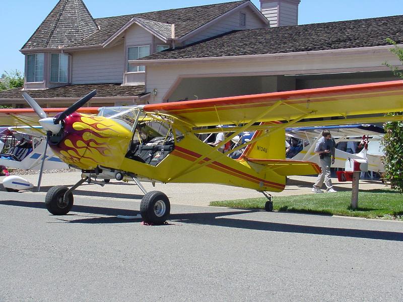

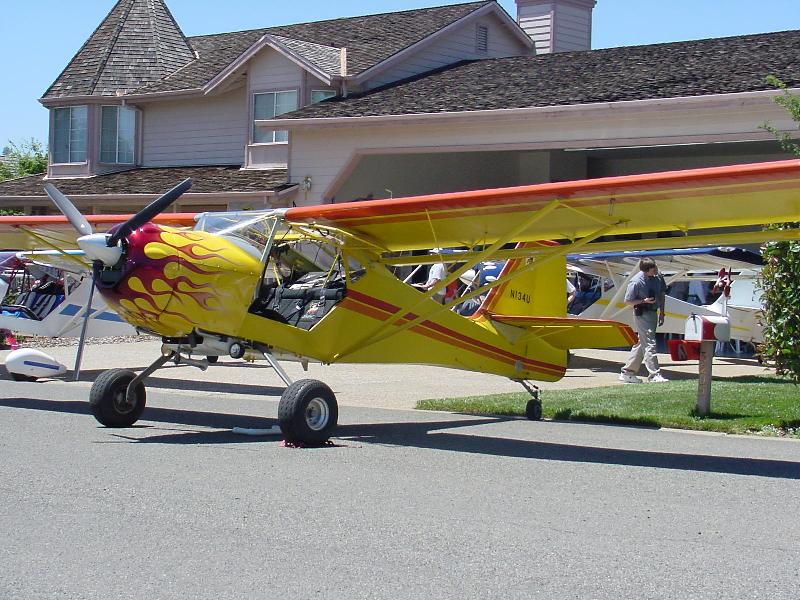

John,
Thanks for the report. This is indeed bad news. If the pilot was the
registered owner, then it is someone I have met as he attended the Cameron
Park Kitfox fly-in. I have been unable to find any local news reports of
the accident.
Attached is a photo of the airplane (N134U) taken by John McBean at the
Second fly-in.
Lowell
