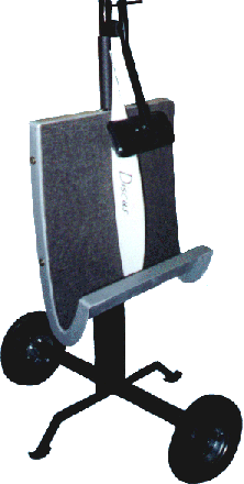

I made a wing dolly based on designs I found on the ‘net and with input from other fliers over here. Couple of pic’s attached. Works a treat and I can single handedly rig and derig in about 15 minutes. Cost me about very little for the bits plus a couple of days work to put together.
Richard Iddon G-RIXS

This dolly looks very nice. Any chance of some more detailed pictures and or drawings showing pivot points, height adjustment and locking, dimensions etc?

The Picture is of the professionally made model which I copied. More details can be found on http://www.wingdolly.reach.net/prices.html . Mine did not have vertical adjustment which I don’t find a problem as I am only using it for the one airplane. I made it so that the dolly sits about 1 foot inboard of the end of the wing with the ‘plane rigged. Up and down adjustment can be made by moving it further inboard or outboard. I made the cradle by taking a splash moulding of the wing at this point using polyester resin & chopped strand mat with an odd layer of bid and reinforcing it with some tubing glassed onto the reverse side. My pivot point is about 20in. back from the leading edge.
I also had input from Bob Harrison G-PTAG and William Mills G-HOFC who have also made similar dollies.
Hope this helps.
