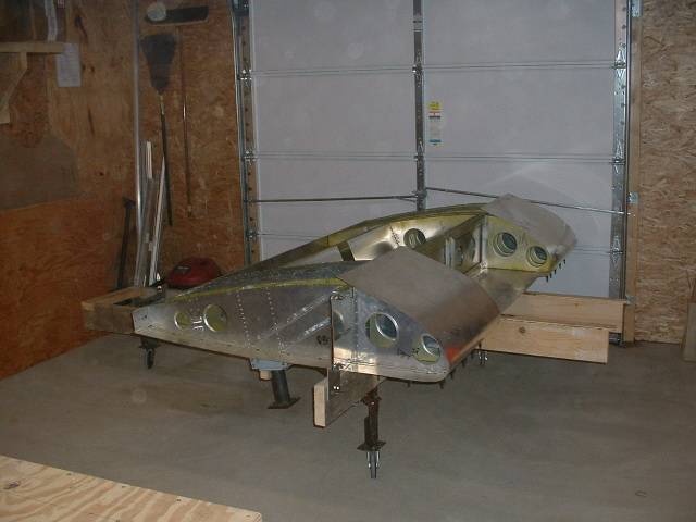

Larry-
Check out Larry Mac's cruciform jig on his website- you'll have to
modify it a bit for an XL, but I think it's the neatest thing since sliced
bread. I built one for my HDS and will never regret it. I can move my center
section/fuse around with one finger.
For an HDS, 16" from the floor to the bottom of the longitudinal 2x6's.
I have about $50 and 25 hrs time in it.
Picture attached, and for crying out loud, don't anyone complain!
Sheesh- I pay about $15/month more for DSL than dial-up. It's worth it in
the time you spend waiting!
Bill Naumuk
HDS Fuselage
Townville, Pa
