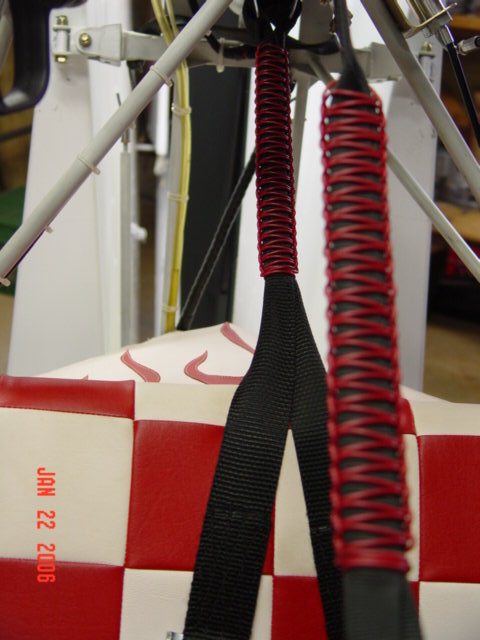

Posted: Mon Jan 23, 2006 3:47 pm Post subject: Re: Shoulder straps too loose |
Hi Guys,
Now leme Splain sometin........
Macreme.......Is " Knot " tying , Which I pride myself in knowing alot of different HANDY knots.....Truckers Knot, Turkey Foot, half hitch, Square,
and a bunch more that I don't know there name...
Sailors know knots.....Is it for knitting ???
That was funny tho...
These had to be tied "in place" because the way I did it was....I threaded the wire thru the belt on "TOP" , (I made a hole with a fat pin)....That way the "Loom" Can't slip down.....
And if you want a good job....do it yerself, don't ask the "little woman"
Well, you can ask her "how the hell do ya do that"...
Gotta Fly...
Mike in MN N381PM

planecrazzzy Guest
Posted: Mon Jan 23, 2006 3:59 pm Post subject: Re: Shoulder straps too loose |
Hi Guys,
One other thing.....Each of the shoulder straps took about 15 min to tie the loom..... it used 14 ft of elec wire( each loom ), and it made aprox a 12" long loom...
It is VERY SIMPLE to do.....It's a simple knot that is repeated over and over....
Gotta Fly...

planecrazzzy Guest
Posted: Mon Jan 23, 2006 6:55 pm Post subject: Re: Shoulder straps too loose |
Hi,
The knots are so tight....When I started the first one....I broke the wire.
So if it was made and you tried to "slip it on yours"....I don't think it could be done.....and if it was made "Bigger" it would look sloppy....
It's too late today, but I can take a few pictures, and show you the knot
it's an extremely simple knot.......ya know how you cross your shoe laces before you make the bow........THAT'S THE KNOT....It's just reversed each time and it incorperates what your tying it to....
Then "YOU" can knitt.....I mean Macreme too !
Gotta Fly...
Mike in MN
