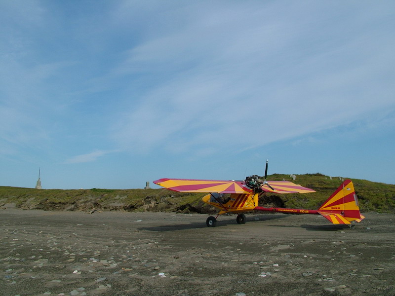

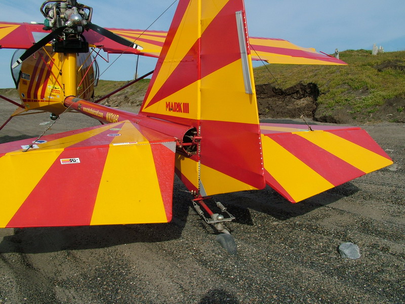

PostPosted: Mon Jan 23, 2006 9:01 am    Post subject: Re: take off with flaps Reply with quote
I immagine you used that technique on the the soft beach in alaska
Morning Mike B/Gang:
That is correct. That was the old Maule 6" solid rubber tailwheel in that picture. In sand, as dry and soft as it was on the beach, 12 miles south of Barrow Airport, the tailwheel acted like an anchor.
Poor planning got me on the beach with full fuel and gear, aprx'ly 1,200 lbs takeoff weight. I should have gone down the Will Rogers/Wiley Post Memorial before I refueled after my flight from Helmericks. Would have been easier to get in and out of the beach. However, the old fat MKIII did her job quite well, as usual.
I now have an 8" pnuematic Maule Tundra Tailwheel which would have done a much better job.
I have attached two photos of Miss P'fer (P fer plane) on the beach on the Arctic Ocean at the Will Rogers/Wiley Post crash site and memorial. Very solem feeling standing alone on that beach where these two adventurers died in 1935.
Little MKIII never ceases to amaze me.

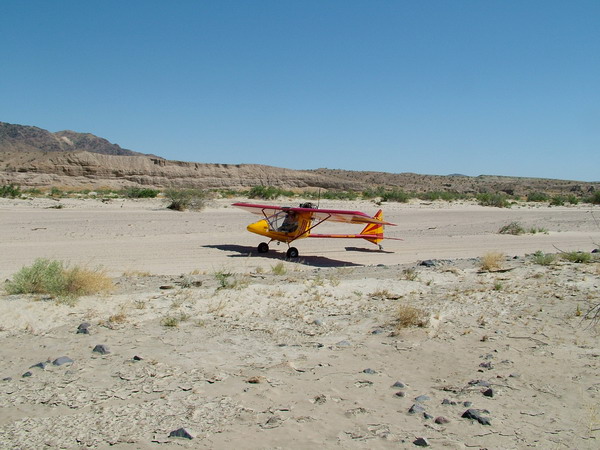

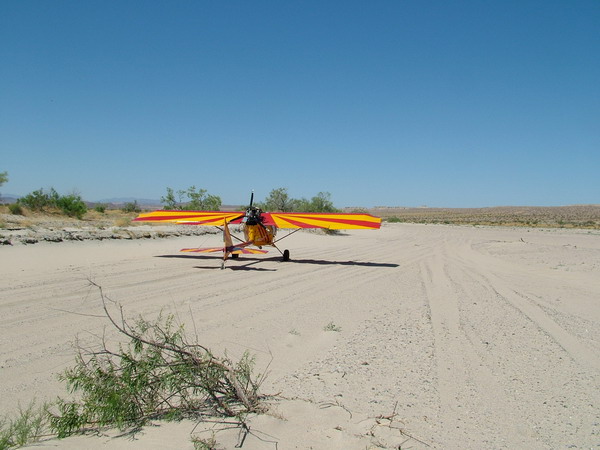

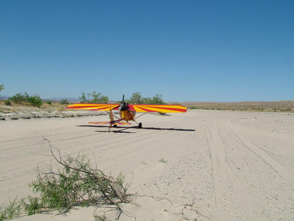

PostPosted: Mon Jan 23, 2006 9:13 am    Post subject: Re: take off with flaps Reply with quote
Hi Gang:
Here was another occassion to use the "flap pop up" technique of takeoff. Was between LA, CA, and Laughlin, NV. In dire need of a pit stop. Nearest airport 30 miles off course. Picked out a dry creek bed, drug it twice, then went for it. Sand was dry and deeper than I had expected. Thank goodness for the displaced main gear on my MKIII. Standard MKIII gear location would have put me on my nose and I would have been looking for another way back to Alabama. In a situation like this, there is no way to know exactly what you are getting into until you have committed to land. I was a little bit, well..........a lot leary, of getting back out of there. Walked my take off track to make sure there wasn't anything that was going to jump out and bite me. Big problem is getting the aircraft to start rolling. I also had dug out in front of the mains to help every little bit I could to get moving. Once I got her rolling, she climbed right up on top of the sand, popped the flaps, and we were flying. That is always a super good feeling when we get back in the air once again.
