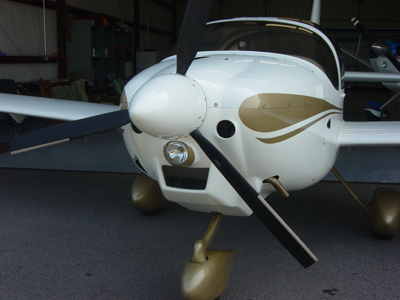

Hi Nico
Good luck getting a small enough light to stand up to the pounding of
the nose wheel. I used the new gas light and made a flange then bonded
it on and filled it out so the light is right above the air opening.
Its tight but work grest. Here is a picture if it comes through.
Jeff
A258 33.5 hrs of flying off the 40. All bugs seem to be gone;)

jimpuglise(at)comcast.net
PostPosted: Sun Sep 03, 2006 11:00 am    Post subject: landinglight. Reply with quote
Jeff-
Who is the Manufacturer of the light and do you have any drawings? It looks like just what I should be doing.
Jim Puglise - A-283

PostPosted: Sun Sep 03, 2006 6:58 pm    Post subject: landinglight. Reply with quote
Jim,
The light was purchased from Wicks Aircraft supply. The item number is
HIDL14. It has a ballast that I mounted on the side of the lower cowl.
It is a gas light so you will never burn it out and it only uses 2.5
amps. I just used it this evening at dusk and it really lights up the
runway. Of course the price lights up the wallet quite well but I
thought it was worth to keep from needing another alternator.
As far as drawings go... I'm sorry I cannot help you. All I did was cut
into the cowl to where the top of the light fit then continued to cut
until the whole light fit without touching the engine and without
coming out close to the prop. When I had it where I wanted it, I got
the clay out and started forming the flange you see. Put tape & release
agent on then laid up 4 ply's of bid over it. After curing I removed
the flange trimmed it up and used the green stuff to bond it back on
the lower cowl. After filling and sanding a few times it was one with
the cowl. I then made the horse shoe piece you see around the bottom of
the light to hold the bulb in place using the same process. Then I
laid in some 2 inch bid tapes, 4 ply's thick, behind the bulb to screw
it in to and hold it from the back. Which allowed adjustment of the
hight of the light. Sorry but with such a limit on my time I didn't do
much documentation or any drawings.
Just get the bulb and get out the clay and the rest will come to you. I
hope this helps.
Jeff
