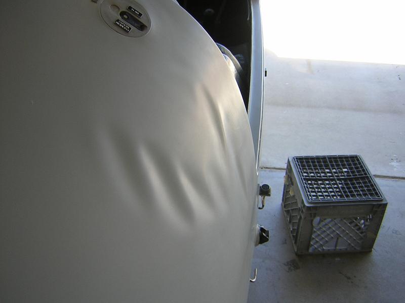

This issue had come up before some time ago and I need my memory refreshed. Am flying around in the hot AZ sun and differential expansion is rearing its ugly head. This is especially true on the fuselage right around the area where the fuel filler maniflod is attached to the inside. Some very prominent waves have developed in the skin here. I am hesitant on filling these to smooth things out. I am assuming that it is reasonable to expect that things will keep on moving through temperature cycling. Does anyone have any history out there with flying in very hot weather and having the fiberglass move around? Have you found this to settle down after some time? Has anyone come up with a different mounting routine for the manifold after getting the ripples?

I believe what you are seeing is what I have been calling print-thru, not heat/expansion related. Print-thru happens on foam cored surfaces that have something glassed to its back, like the fiber glass reinforcing for your fuel filler neck. As your plane ages, you will find more print-thru on the fuse and wings.

I have seen what you are talking about, this seems to be a little more extreme, I have attached a photo.
Steve.

This was one of the topics discussed in the Aeropoxy forum at Oshkosh this year. They are a big proponent of post-curing prior to painting. They claim that all fiberglass should be post-cured. I am a long way from being an expert; that is why I was in the forum. They suggest something like 140 degrees for several hours. Those of us living in the heat (AZ, FL, etc.) could probably get there by putting the pieces in the attic for a day. You may want to talk to them about your problem. The other thing they pointed out is that most of the organizations selling their, and other, products are not well qualified to address problems such as print through. You may want to try contacting them and see if they have a fix prior to doing anything.

It looks like the lay-up under the skin has come through as promised to
me if I didn't place a slice of foam under the skin before I glassed
the fuel filler in. This is what we did at Flight Crafters as per their
recommendation because of that very same thing. Your picture is the
first time I've seen it. Is this the only place your experiencing it? I
believe this is one of those manual fixes that needed to happen years
ago. It's a problem everyone new about but never printed the fix.

Mine has done the same thing and is very visible. I believe in time they all will do this if exposed to heat (and I live in the not so sunny northwest) and assuming the same construction , I know a few years ago Andy "fixed" the US demo before a show by sanding down and applying fill and bid and refinishing. I believe he also went inside and reduced the attached area of the fuel filler. I also believe he said that structurally there was no issue. Mine has not been "fixed" yet and I tend not to notice it after 4 years.

A picture IS worth a thousand words, this does not look like ours. Our 'print-thru' areas are exact replications of the glass bonded to the other (inside) side of the skin. Yours seems more like ripples in the fuselage. I haven't seen anything like it before.

The version of the wrinkling or waving of the fuselage skin on my aircraft was
below the filler and before the joint line of the fuselage halves. It was
caused by the fuel tank permanently distorting by the weight of fuel and
pulling on the filler tube via the 'flexible' hose. The builder's manual
instructs the builder to strap this filler tube to the fuselage skin in the
wrinkled area. The cure was to cut this strap and free the tube from the
fuselage. The wrinkles came out over a period of days in hot weather (for the
UK: max about 32C). So far after 3 months I have seen no other effects around
the filler and the filler to fuselage seal.

It was a piece like the one under the door sill. We bonded it to the
fuselage then covered it in 2 layers of bid. The goal is that the
filler tube is not in direct contact with the skin. I cannot answer why
this has kept the outside skin straight but I have never seen a
problem. Others that have gone through the Florida build center have

After thinking about it for awhile I have come to that conclusion. The
plan is to get the dremel tool out and cut the straps attaching the
manifold to the fuselage skin. Push the beast out in the driveway under
the AZ sun for a weekend and see if it flows out back. I put a couple of
good ripples in my wing by carrying it improperly and the fiberglass flowed
out and smoothed nicely on a balmy 105F day. The manifiold will be then
gingerly attached with some pliable RTV type material or a single strap
with a very large radius stress relief in it.
> Steve Hagar
> N40 SH
> A143
> 13 hrs
> Steve Hagar
> hagargs(at)earthlink.net
jeff(at)rmmm.net
PostPosted: Wed Sep 13, 2006 7:43 pm    Post subject: Moving fiberglass Reply with quote
Yes. It's been a couple of years but it was about the same.
Jeff
A258 Just had the best evening of flying in the central USA in months!
On Sep 13, 2006, at 8:09 PM, Fred Klein wrote:
Jeff,
By referencing the piece of foam "under the door sill", I take it
you're referring to the 1/8" thick foam sheet...(?)
Fred
On Wednesday, September 13, 2006, at 11:55 AM, JEFF ROBERTS wrote:
> Fred,
> why this has kept the outside skin straight but I have never seen a
> said the same.
> Regards,
> Jeff
> A258 Headed to the airport tonight!
