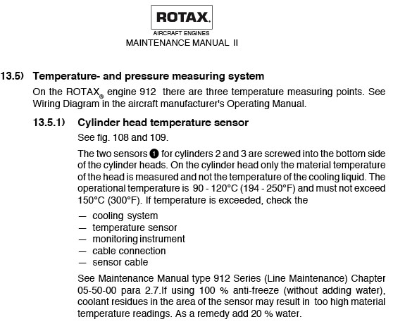

Thom Riddle
Joined: 10 Jan 2006 Posts: 1597 Location: Buffalo, NY, USA (9G0)
Posted: Sun Sep 03, 2006 5:27 am Post subject: Allegro 2000, 912UL Initial Engine Test Run |
Hugh,
Though they do have a very explicit run-in procedure for their 2-stroke
engines, Rotax does not require a run-in sequence for the 912 series
engines. Maintaining all parameters within normal ranges is important
though, especially while the engine is new. You allowed the oil
temperature to get above the normal range (90-110C) but kept it below
the max of 140C so I would not be too concerned about that. There is no
normal range specified for the CHT and you kept it below the 150C max.
Again no real concern. Oil pressure was maintained in normal range. No
concern there either. Note the temperature limits are different for the
912ULS engines.
Your report was very thorough with the exception of what the
temperatures were when you shut down the engine. You stated that you
let the engine cool down for 3 minutes but did not mention what the
temps were when you shut it down. In normal operation of our Allegro
2000 912UL, the engine has had plenty time to cool off for shutdown
after final approach and landing at idle, taxiing off the runway and
taxiing to hangar. If you don't let the engine cool down properly, then
the overflow coolant at ambient pressure would be expected to boil. On
static runs I would do the cool down at 2,000 rpm until the oil
temperature dropped into the low end of normal range before shutting
down. As I said, in normal operations, we've never had to let ours cool
down after taxiing to the hangar.
Rotax recommends letting the engine cool down at 2,000 rpm before
shutting it down, not 1,000 rpm. 1,000 rpm is too slow for this engine
and idle should be set to 1400 rpm minimum to 1800 max. Note that the
idle speed must be set when the engine is at normal operating
temperatures. If done at cooler temps, it will change when warmed up to
normal temps. Extended idling at too low rpm on the 912 can cause
gearbox damage. Since the Allegro glides so well, you will find that
setting the idle at the low end of the 1400-1800 rpm range is best. If
you set it at the high range, you will have trouble keeping the
airspeeds down on final approach.

Thom Riddle
Posted: Mon Sep 04, 2006 6:11 am Post subject: Re: Allegro 2000, 912UL Initial Engine Test Run |
Giles,
I have reviewed, again, my Operator's Manual, Installation Manual, Line Maintenance Manual, Heavy Maintenance Manual and all Service
Documentation available at Rotax-owner.com since July 1998 (date of my Operator's Manual). The only place I found what could be interpreted as a "normal cylinder head temperature range" is in the Heavy Maintenance Manual. See attached image. All the other documentation I've looked at contain only a Maximum CHT specification. You will notice that it says the "operational temperature" is 90-120C (194-250F) with a MUST NOT EXCEED CHT of 150C (300F). It also says what to do if the maximum is exceeded. In Hugh's case, he did not exceed the maximum. I don't think Hugh should be at all concerned about having run his engine at 130C CHT.
I'm not trying to be argumentative, just wanting the facts to be known. This is the best information I've been able to find on the subject. If you know of another more up-to-date source from Rotax, please let us all know.
| | - The Matronics RotaxEngines-List Email Forum - | | | Use the List Feature Navigator to browse the many List utilities available such as the Email Subscriptions page, Archive Search & Download, 7-Day Browse, Chat, FAQ, Photoshare, and much more:
http://www.matronics.com/Navigator?RotaxEngines-List |

Gilles.Thesee(at)ac-greno Guest
Posted: Mon Sep 04, 2006 7:38 am Post subject: Allegro 2000, 912UL Initial Engine Test Run |
Hi Thom,
| Quote: |
Documentation available at *Rotax-owner.com* since July 1998 (date of
head temperature range" is in the *Heavy Maintenance Manual.* See
Operator's manual Rev 3, July 2004 page 10-1, states the limitations
and best operating ranges.
An updated version of the various manuals can be downoaded from the
Kodiak research website : http://www.kodiakbs.com/tiintro.htm
The Rotax-owner's website provides the list of effective documentation
for the 912 :
http://www.rotax-owner.com/SI_TB_INFO/returndoc.asp?PATH=http://www.rotax-owner.com/si_tb_info/serviceb/sb-all-000-r4.pdf&DOCID=SB-912-000&S_TYPE=SS
| Quote: | You will notice that it says the "operational temperature" is 90-120C
Let's try a thought experiment. Suppose with start with two brand new
identical engines. One is run at 149°C from the start. The other is
thoroughly run-in and used inside normal range by a caring owner, but
one day, experiences a short temperature excursion up to say, 151 °C.
Would you still say the #1 was soundly used, and the #2 engine is to be
grounded ? What happens between 149.9°C and 150°C ?
Limits are just that, limits. I would not be too confindent with an
engine that has been consistently run to its red line, just because "the
pointer did not pass the red mark".
Engines are best treated with care, and not thermally abused.
But of course, it's not my engine.
Best regards,
Gilles
http://contrails.free.fr
| Back to top |
