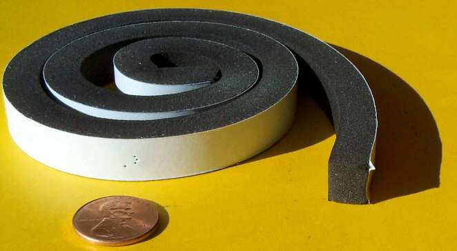

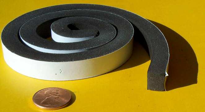

Below is a picture of the sample door seal from I received from Aircraft Door Seals, LLC.
I looks to be a firm texture closed cell foam with a self-adhesive strip. www.aircraftdoorseals.com

Kevin,
I installed these in my Piper, and have been disappointed. Not so much with the product but how they've worked. IMHO in the Piper the location is not the best...it should be on the door and not in the opening. Feet catch on them along with hands and the rivets in the door pull the foam away from the planes frame.
In an experimental you can get your own closes cell foam and try with out spending $70 to get similar results. But please do what you think best. As I said I was disappointed with this product in a Cherokee and it was most probably due to the foam location and not the product itself.
Just my opinion, though...
Patrick

I would agree with Kevin. While Dick Russ has modified his door seals for the Cherokee recently to address the issue of people ripping the lower seal while getting in and out of the aircraft, it is awkward at best. If the seal is totally on the door, then there is almost no risk of getting damaged by passengers.

How does this stuff differ from weatherstripping I can buy at Lowes? Sure looks the same!

It has a memory, so that once it has taken a set, it doesn't fight the
door, but does provide a good seal. I don't think you will find any
thing quite like it in the home depot/lowes type store.
Contrary to Patrick's experience, I have it on my plane, no problem, but
I rarely carry anyone but my SO..so maybe we are more careful than the
average passenger. It isn't a big deal to splice in a replacement piece
if it does get damaged.
I'm curious about the comment that Dick Russ somehow changed the seal
for the Cherokee? I don't see anything on his website to indicate any
change.

It's memory foam...and for a Piper they have an STC...Lowe's or HomeDepot do not carry STC's...LOL

Kelly for the most part the damage was caused by the rivet heads that pulled the tapped side away from the inside door...the damage/crap part was mainly on the inside door jam and not on the opening as Dick likes to discuss and tell us that is our going in and out of the door. The product from the guy in Washington State is placed on the door...the STC was written for the wrong location...

Well, I guess the shop heads on Piper rivets are sharper than those on
the Mooney door. Don't know why that would be the case. He does NOT have
an STC. His seal is FAA/PMA approved for Piper, Mooney and Cessna
aircraft. The difference is log book entry vs filing a 337.
