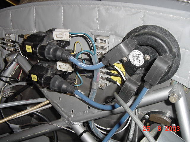

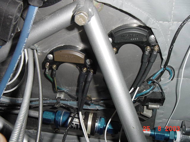

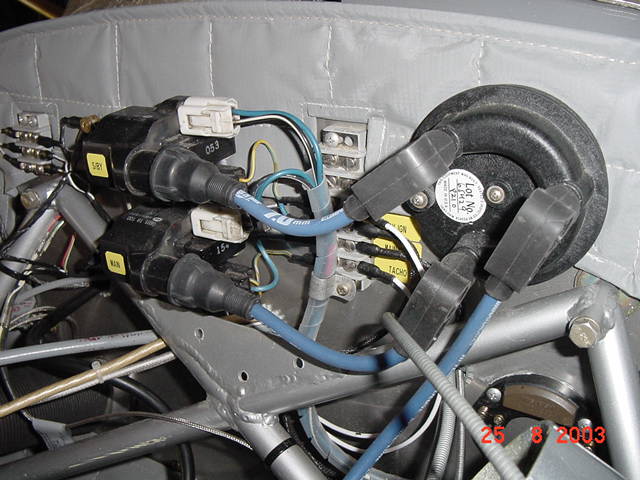

I am running an EA 81 with std dist but have dual trigger units, ign units a
coils fitted and runs through an MSD two to one HT joiner. See
http://www.sportflight.com/cgi-bin/uploader.pl?action=view&epoch=1113275709

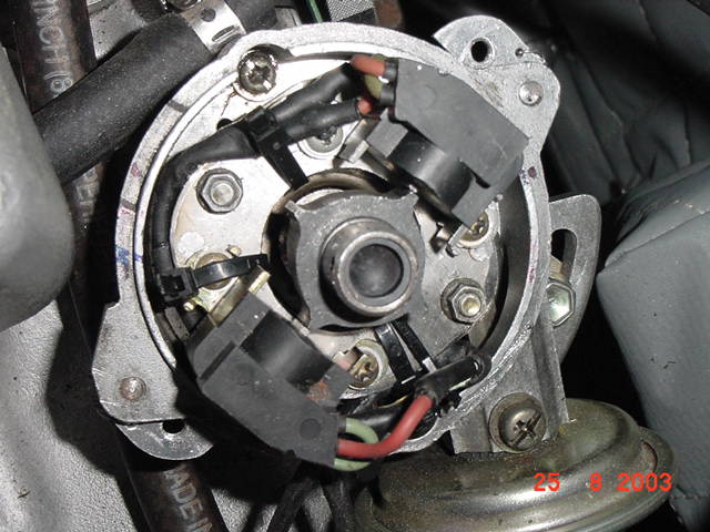

All the parts are off 90-99 Ford Laza, Mazda 323 or Nissan Sentra as known
here in New Zealand. I'm sure you would have similar models in the US,
perhaps diff names but the engine is in the 1500 - 2000cc range. Components
made by Mitubishi Electrics. I can send you more shots if you like, I
replaced the Sub dist base plate with a fabricated a new plate and fitted
the the trigger coils onto it. Used the std sub reluctor with a bit of
modification. Works super well.
