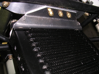

Posted: Fri Aug 25, 2006 4:11 am Post subject: 601 XL Rotax cowling needed |
Doug, as it turns out I'm having to order the whole kit from CZAW because of the licensing termination with Zenith. Nick told me that most of the current XL sales are Jabiru powered and not Rotax which is why the whole cowling thing is up in the air (no pun intended)
CZAW sent me some great pictures of the Rotax install with the cowling and everything is in the front now. My only concern is the stock muffler might interfere with the oil cooler position since it's right in front of the can and the front down-tubes from the 912 go into the can from the front. I've seen some pictures with another exhaust and the tubes go into from the sides... Perhaps you can shed some light on this setup since the FW kit photos from ZAC show the earlier setup like yours with the side-mounted oil cooler.
BTW, the CZAW cowling is carbon fibre so it should be very light...
Some pictures are enclosed that might help. Sorry about the small size but I'm not sure if the Matronics system will send them out and kibosh the sizes...
Trev Page
