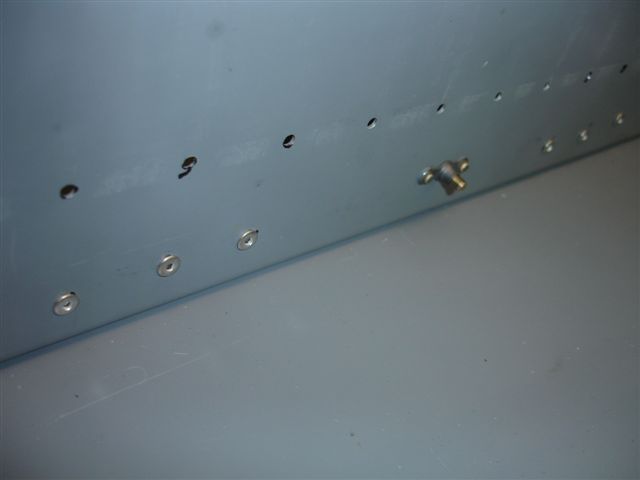

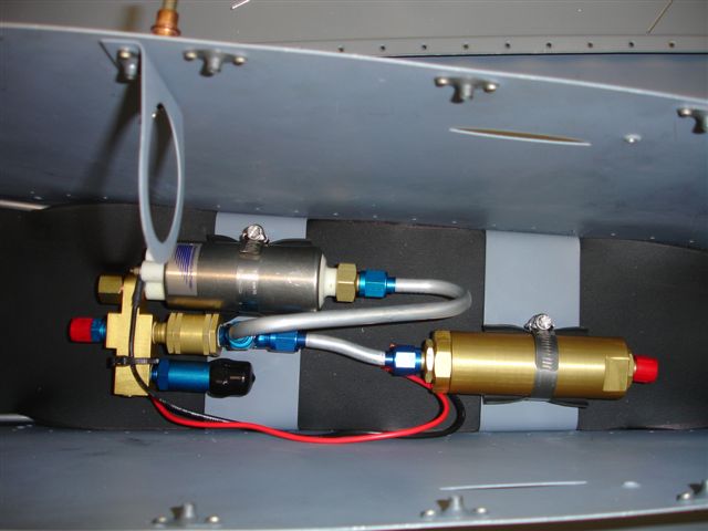

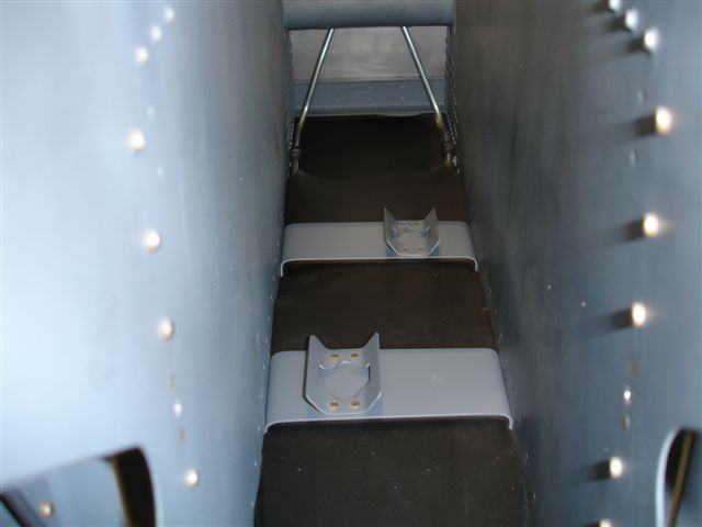

Here's what I am doing for the HTS (Hot Tunnel Syndrome). I made two brackets that raise up off the bottom floor by 1 inch. They are simple U-brackets made from .050 2024. The existing cradle brackets are then riveted on and three holes on each flange are then riveted to the Tunnel side walls.
I have a"KoolMat" insulation layer laying on the floor followed by 1 inch of closed cell foam I bought from Wicks. The fuel lines will be firesleeved when I finish making them.
SO much easier working in the Tunnel without the side skins on!
