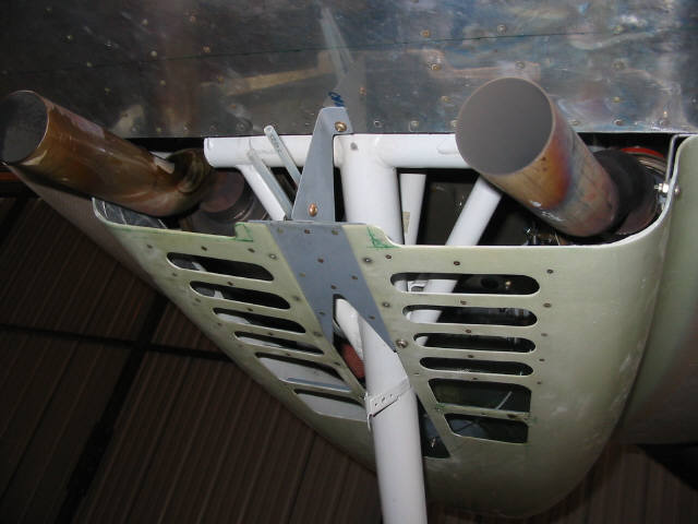

    I heard about the tunnel heat problem a little late and I built only a few preemptive things into the plane. I put ceramic gaskets behind the heater valves to keep heat from transfering to the firewall/tunnel. I installed a blast tube on the firewall forward of the tunnel. And I installed a computer fan in the tunnel cover just over the fuel pump (this actually made a big difference in tunnel heat once I turned it on.)
    These things didn't fix the problem, but here's what did. I was having CHT and oil temp overheating problems and one of the things I did to fix this problem was increase the cowl air exit area to improve air flow. As you can see from the photo I enlarged one of the louvers and added an additional one - this didn't make much difference alone. Then I trimmed the aft edge of the "reverse scoop" forward about an inch (see photo). This increases the exit area, but I think it also allows the hot air to move down and away from the fuse and disipate faster.
    I'm sure that I added extra drag to my plane, but the engine and tunnel are now cool.

				Congrats on the fix!   That really doesn't look bad at all.
 I wonder if just trimming that aft 1" of the cowl alone would
 improve things the majority of what you noticed.
 At any rate, it's great to see someone trying different things.

     Great fix and I’m glad it worked so well, may end up doing that myself.  The really impressive thing is the nerve to make the changes since they would be tough to undo.  That’s the great thing about homebuilts, think of a fix and act on it.  Not everyone would have the conviction to do it though – great job!
