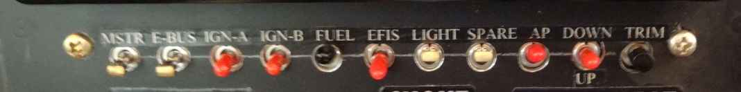

I suggest that you use fuses for everything.
Then use miniature toggle switches for those items that you want to shut off.
https://www.mouser.com/datasheet/3/339/1/MN_ToggleSections_DP.pdf
In my plane, I mounted all switches on a rectangular piece of aluminum with a nutplate at each end.
Then mounted that aluminum behind the instrument panel with two screws.
If necessary to service a switch, remove the two screws and all switches are removed at once.
Of course the wires are longer to form a service loop.
 Filesize:  61.7 KB
