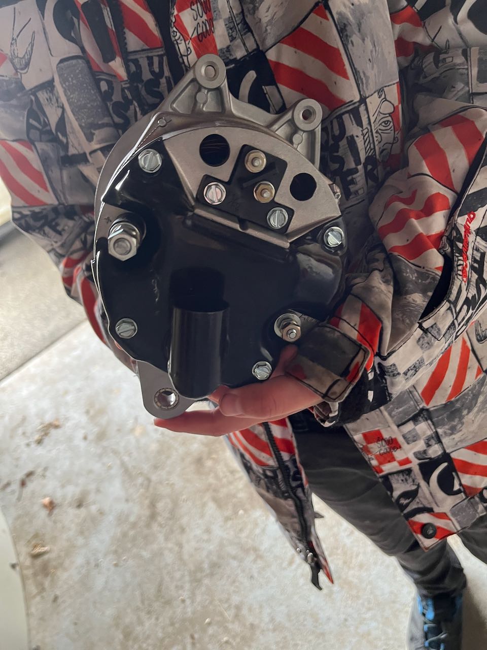

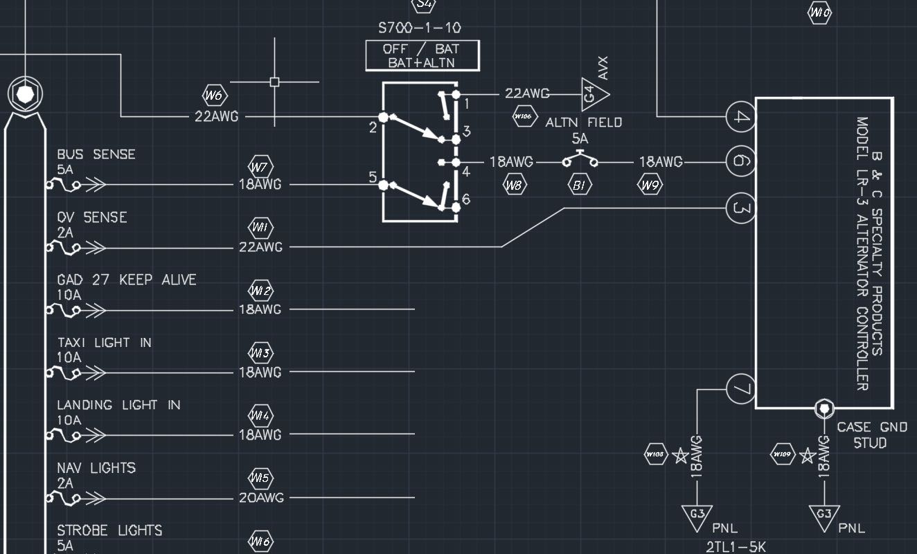

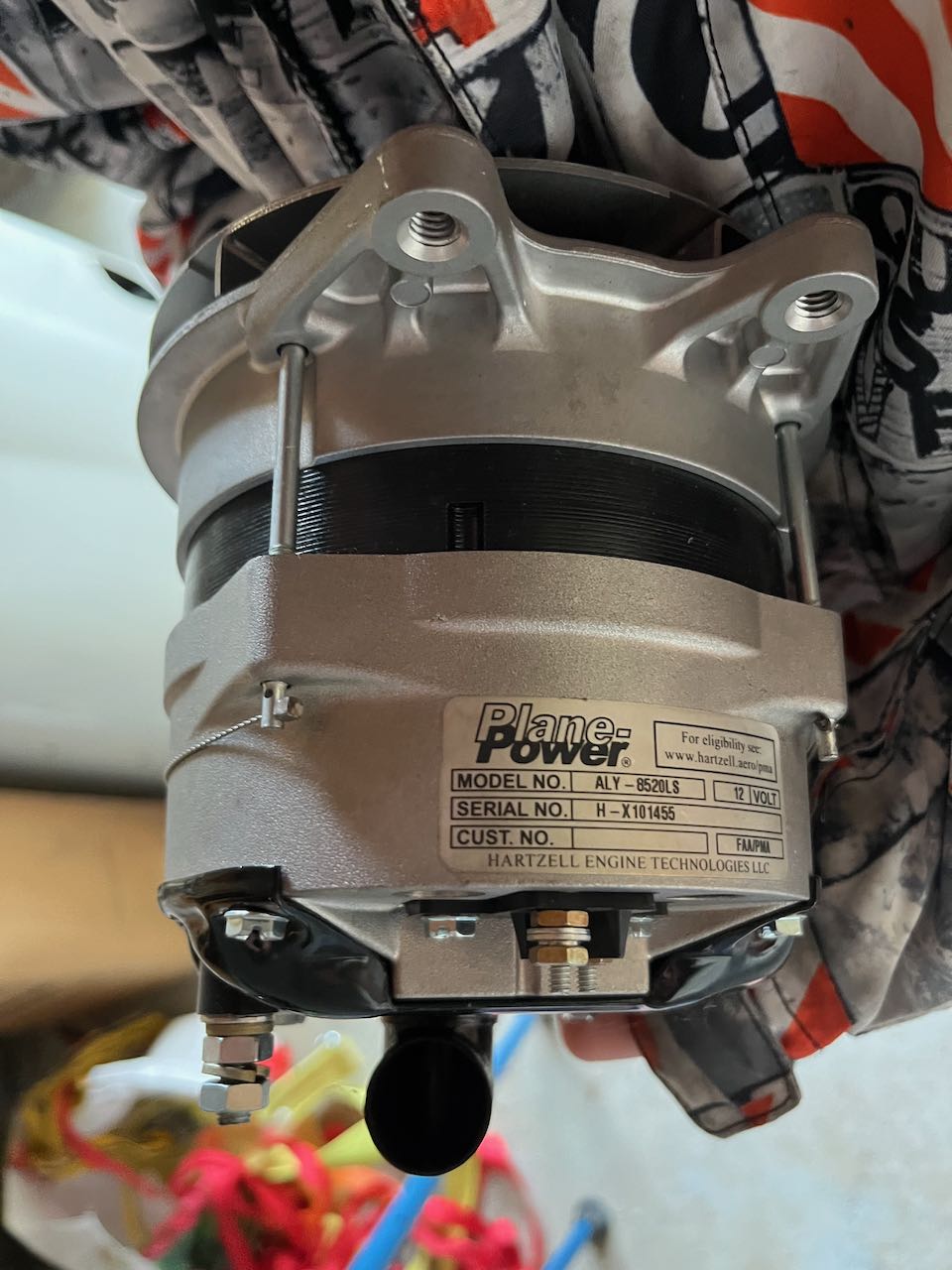

I also have a regulator/alternator integration question:
My main alternator is a Plane Power ALY-8520LS, and I plan to use a B&C LR3E regulator.
From what I understand:
the LR3 field output should go to the alternator F1 lead
F2 on some Plane Power/Hartzell units is either internally grounded or intended to be grounded externally, depending on configuration
I do not see a clear need for the AUX terminal when using the LR3E as a basic external regulator
Am I understanding this correctly?
More specifically:
Is the Plane Power ALY-8520LS considered fully compatible with the B&C LR3E?
Should I connect only F1 to the LR3E field output?
Should F2 be grounded, or is it already internally grounded on this alternator?
Should the AUX terminal remain unused in this installation?
My objective is to keep the architecture simple, robust, and as faithful as practical to the Z-12 concept, while still matching the Garmin/G3X installation requirements.
Thank you again for your time and for reviewing the updated diagram.

Why not use Z101 which AFAIK is intended to obsolete Z12. Z101 puts the aux alternator B lead on the battery, this way in case of smoke-in-the-cockpit-main-master-off the main bus is down and the e bus still has an alternator.
Are you aware of Monkworkz 30A PM vacuum pad generator? Starts and runs with no battery present. Delivers 30A at 1800 Lycoming RPM. Its B lead could be connected to the e bus, can't go on the battery due to parasitic load.
There's a later rev N of Z12 versus the rev M you started with. I don't know the differences.
Suggest you label your schematics with rev number and date. It's also valuable to show where the firewall is, and the baggage bulkhead in case of rear battery.
Bob Nuckolls recommends using LR3 for backup alternator. BTW SB-1 will flash the lamp over 20A even though the alternator is capable of more at cruise RPM. Lamp is an "idiot light"... better to look for voltage sag.
AFAIK Z template schematics have been moving to fuselinks for alternator B leads since about 2020.
I personally use a 100A MIDI fuse on a 60A alternator and a 50A MIDI fuse on a vacuum pad alternator.
B&C 410-H puts out 32A at 2700 Lycoming RPM.
Re shunt sense wires: IMO shop made 24 awg fuselinks connected to 20 awg feeders to the electronic box are easier / more compact / more reliable vs fuses. Ref Bob Nuckolls' fabrication instructions.
Note COTS fuselink wire smallest available in small quantity is 20 awg.
The alternator field feeder between the bus and the 5A breaker is protected by FLW because a fuse will open before the breaker does and the crew resettable breaker is needed in case of "nuisance" trip.
Newer Z schematics show 20 awg FLW to 16 awg feeder; this is for COTS 20 awg FLW. Older Z schematics showed 22 awg FLW to 18 awg feeder; this is for 22 awg shop made fuselinks.
Your "... -Model-2.pdf" schematic erroneously labels the master switch as 1-10.
-2 also incorrectly labels the bus / field supply / power feed to the regulators as "bus sense".
