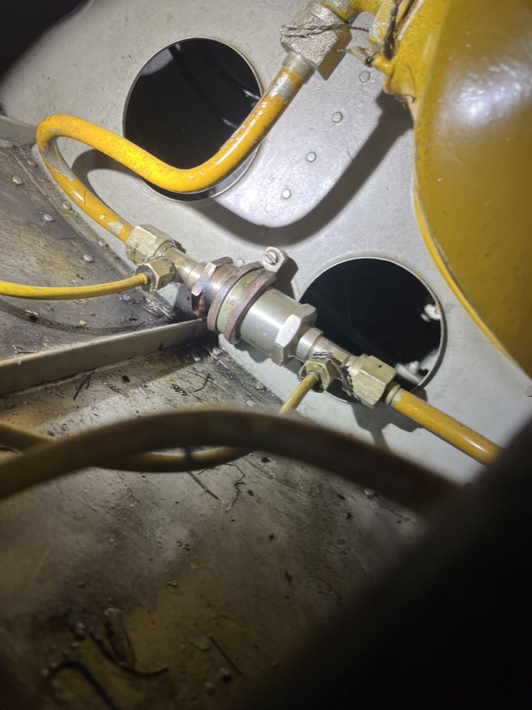

Hello,
Attached to the message a photo taken under the two tanks of my Yak50.
Before dismantling this filter, I would like to find a diagram.
Is somebody know this material, I imagine there must be some joints…

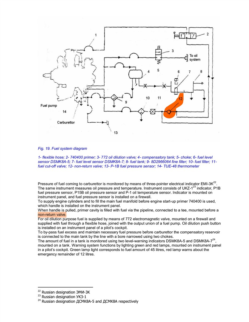

the picture is not of a fuel filter, this is a non return valve. Item 12 in the attached picture, the small lines run to/from primer.
Best is not to touch it if your fuel primer works normally.
The fuel filter is on the left side of the fire wall and easily cleaned during maintenance.
