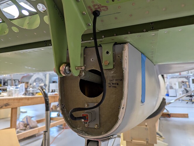

I was never fond of the stamped pins of the Molex connectors, neither how bad they sometimes fit together Smile
Now due to a discussion on another Forum (glasair owners) I became aware of the Deutsch connectors.
Seems they are very wide used in the car industrie and you can get machined pins (similar to the d-sub pins).
They come in several sizes/ratings:
DT Series
connectors accept size 16 (13 amp) pins and sockets and accommodate wire sizes 12-20 AWG
DTM Series connectors accept size 20 (7.5 amp) pins and sockets and accommodate wire sizes 16-22 AWG
DTP Series connectors accept size 12 (25 amp) pins and sockets and accommodate wire sizes 10-14 AWG
DTHD Series connectors accept size 4 (100 amp), size 8 (60 amp), or size 12 (25 amp) pins and sockets and accommodate wire sizes 6-14 AWG
There is a nice set available in the US on Amazon from JRready:
https://www.amazon.com/dp/B0DB1YMX34?tag=coolairp-20
When you compare please be aware to check you have the solid pins not the stamped.
They offer as well add ons for e.g bulkhead connectors see below.
For Europe I did buy things seperate as the shop does not have the same set.
The pins delivered with it are down to AWG16 I did order additional pins for AWG 14 for my 7Star lights.
Hope someone finds this info of help!
Merry Xmas all
Werner
