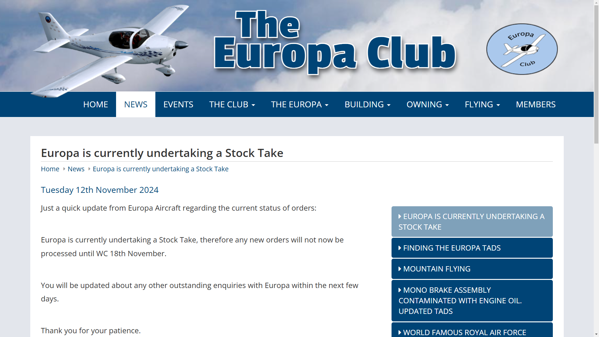

PostPosted: Thu Nov 14, 2024 11:08 am    Post subject: Tail plane questions Reply with quote
Alex,
Have you seen this message which is posted on the Europa Club website News page?

alex(at)kaarsberg.org
PostPosted: Thu Nov 14, 2024 12:43 pm    Post subject: Tail plane questions Reply with quote
James,
You have no idea how that relieves me, I had just sold the kit when the new owner told me they seemed to have shut down.
Having had my mind on other things for years, I have not followed up on informing myself, much appreciated!!
Alex Kaarsberg
