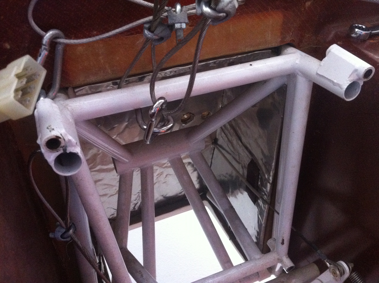

I'm at a point of installing my Jabiru engine and note that the Builders Manual in section 31 calls for the construction of a fire-proof barrier that is fitted to the landing gear frame.
I made a cardboard cutout as per the drawings in my manual only to find out that the drawing appear to be only for the Rotax installation and does not fit my Jabiru engine frame. So....Im wondering what other Europa builder who have Jabiru engines have done?
It appears to me that the Jabiru engine would site between the mounts and protrude further back than the Rotax. Therefore Im at a loss on how to proceed.
Any help from experienced builders would be greatly appreciated.

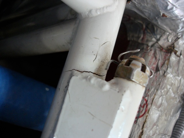

 Filesize:  80.22 KB
 Viewed:  19668 Time(s)
Mod 72 - Engine Mounting Frame Strengthening - MANDATORY.pdf
Download
 Filename:  Mod 72 - Engine Mounting Frame Strengthening - MANDATORY.pdf
 Filesize:  315.16 KB
 Downloaded:  1091 Time(s)

Hi Tony,
Jabiru powered Europas are pretty rare (I don’t know of any) and I’m not sure if there are any builders who could advise you.
I think your only option is to trial fit the engine and make up your own templates …it’s all part of the fun of “homebuild”.
One thing that I did notice from your photo is that you are using a pre - January 2007 landing gear frame. These had thin-wall mounting tubes and were found to fatigue fracture in service. I’ve attach a picture of a typical failure. As a result of this, Europa issued a mod (Mod 72) that required you to ream out the top tubes and insert a reinforcing tube. I’ve attached that instruction FYI.
Since you haven’t yet installed your engine, now would be a good time to strengthen your frame.

I totally agree Nigel,
It is just added insurance against cracking.
Dave Conrad and I just finished his. Reaming the lower tube requires an extension on the reamer. Dave bought a hand reamer square end so we could fit it to a ½ inch extension and drive it with a drill. Dave elected to stop at the bolts. I think I would remove the bolt and drill the insert as well in the future.
Bud Yerly

My personal opinion is “yes”. The reinforcing tubes supplied by the factory as part of the Mod 72 kit were about 100mm (4.0”) long as I remember. This was intended to span the area known to fail on the top two tubes.
The latest spate of failures is occurring further inboard on the lower tubes. For anyone with a pre 2007 frame, I would suggest reinforcing all four landing gear mounting tubes for their full length. After January 2007, the factory produced the LG01 frame with thicker walled top tubes, so in this case, only the lower tubes would need reinforcing.
I am currently overhauling a mono and am actually in the process of writing up this mod to gain approval from our own regulating authority.
I notice that you fly a conventional gear. Since the landing load paths are completely different, I would think that you are highly unlikely to suffer from fractured lower tubes, so this discussion is probably academic in your case.

By any chance, do you know the wall thickness of those lower tube stubs?

The wall on the early frames is .049.
