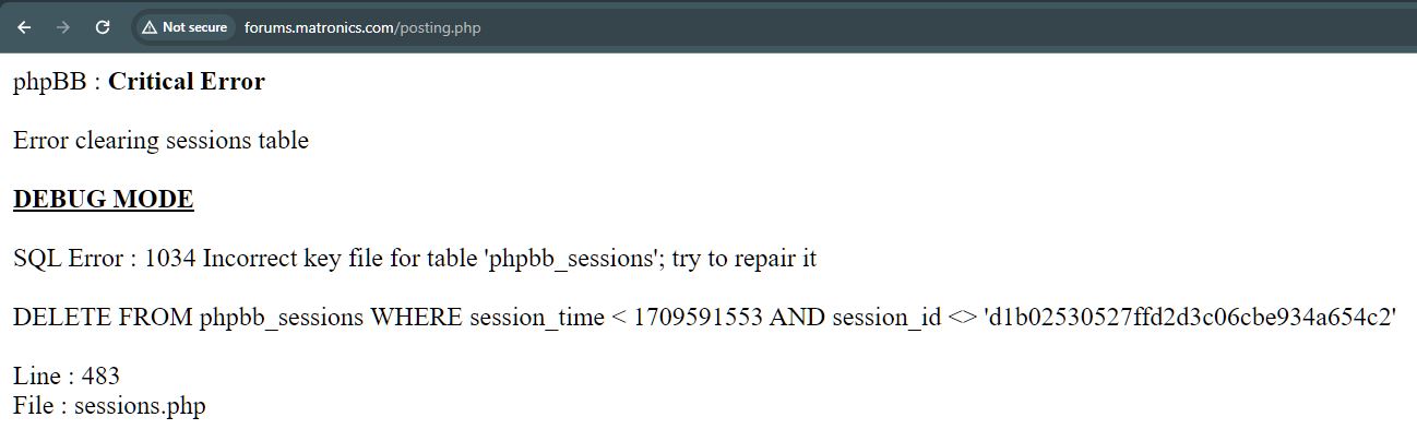

Matt, I've been seeing a lot of "phpBB : Critical Error" messages lately when viewing the AeroElectric-List web interface. Repeated forced-reloads will sometimes cause it to load, but it's making the forum virtually unusable.
Here's a screenshot, taken after clicking the "Preview" button on this post.

Internet Spammers fill up the Sessions table causing this error. I've cleaned the table, should work better now.
Thank you for reporting.
