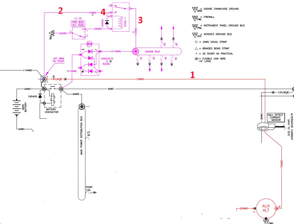

I have an additional question here concerning Z101 which I use in my RV-10

there is not a lot of echo on my question, I would appreciate if the "usual suspects" Wink could give me a short feedback if I'm on the right way to reduce wire runs.
Many thanks for your help, plan is to crimp the wires next week Smile

I have an additional question here concerning Z101 which I use in my RV-10.
On the RV-10 the battery is behind the baggage compartment so that brings some question concerning wiring here the part of Z101 which shows that:
[img]cid:part1.xfEMePld.U60UWSQT(at)gmx.net[/img]
The wire marked with 1 (feed line aux alternator) would be about 14 feet long, I plan to protect that wire with an ANL 40A fuse on the FW close to the alternator, but it would be always (unfused) hot on the other side as the battery is directly hooked to that wire.
The wire marked with 2 could be very short if the relay 704-1 is placed close to the battery
The wire marked with 3 would be again about 12 feet long, but would only be hot when either relay is on.
In this situation I would have 3 wire runs along these 12 feet #1, #3 and the starter wiring (I use 2 AWG there because of length) and #1 and the short #2 would always be hot.
Now I could reduce the wire runs, if I would move the Alt Bus feed relay (704-1) to the front and hook #1 wire directly on point #4 to the relay,  I would still have the long #2 and the short #1 wire hot. But in summary its still one hot wire run along the fuselage.
I could mitigate that by moving the ANL fuse to the rear, but introducing a risk, if the Aux alternator is on, that the protection of the wire is on the other end of the source (Aux alternator).
Many thanks for the consideration and tips on that question what is best or common practice.
Cheers from Switzerland
Werner
