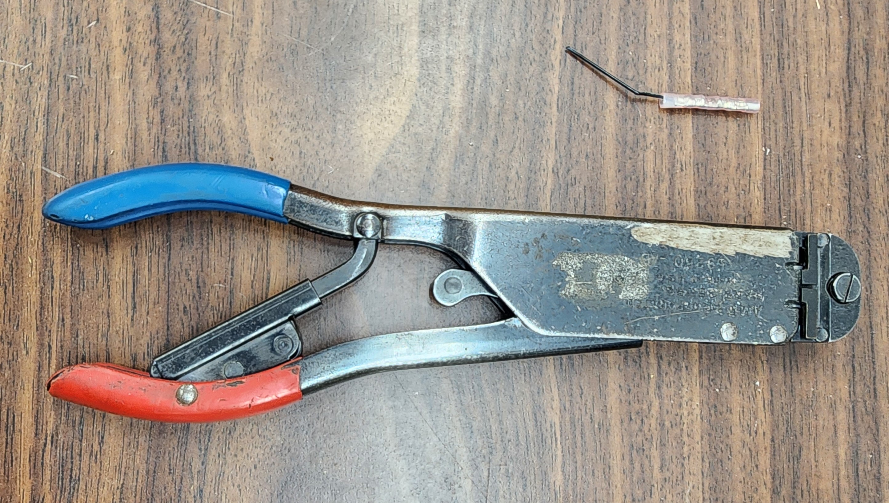

My very basic test rig with somewhat empirical results- no measured data.
Objective: observe failure of fusible links of various lengths when subjected to a high current short circuit event.
12V wet cell, new, fully charged battery
Knife switch
18 ga tefzel feeder, 20" length x2
PIDG style butt splices (red)
Camera
DUT: 2", 6", 13" lengths 24 ga tefzel FL (M22759/16)
Procedure:
Fabricate fusible links of 2, 6 an 13 inch lengths
Crimp w/ AMP PIDG crimper to
Feeder 20" 18 ga tefzel
Clamp feeders to B+ Knife switch and B- battery terminal
Start camera video
Rabidly close switch
Two inch FL setup
[img]cid:ii_lqo7bxra0[/img]Crimp tool and butt splice
[img]cid:ii_lqo9ivb81[/img]
results:
http://tinyurl.com/mryadbfx
No fiberglas sleeve was used so that failure could be observed.
Comments, questions, critique!
...chris

That's a great demonstration Chris.
And it evidences exactly why I would not use fusible links in an aircraft, or automobile for that matter.
There's smoke, there's fire, and there's molten metal!
With most fuses the burned wire, smoke, and fire are contained.
Cheers! Stu.

Chris' demonstrations are essentially the
same as those I conducted 23 years ago
when this article was published on
the website.
https://tinyurl.com/msx5ofe
The original impetus for
the article was to craft a robust,
minimum labor, alternative to the
signal leads from a firewall mounted
shunt extending to the instrument on
the panel.
In this special case, the links
were out on the firewall . . .
having the links 'fuse' under
fiberglas sleeving presented
no special hazard.
AeroElectric -and- B&C sold
a goodly number of kits that
included the somewhat hard-to-
find silicon impregnated fiberglas
sleeve.
This was before I became aware
of sources for bulk, cut-n-terminate
fuse link wire which is now readily
available from a constellation
of sources.
This stuff is ordinary, stranded
copper wire insulated in 'magic
plastic'. One of the first materials
to be qualified was 'Hypalon' by
DuPont. It was favored for use in
all manner of industrial grade
electric vehicles including over
the rails engines, mining engines,
cranes, etc. Any situation where
people shared close spaces with
really fat wires.
The smoke emitted by a faulted
cable was very low toxicity and
irritation. Hence it became a go-to
choice for fusible links as well.
The stuff is TOUGH! It's used to
fabricate all manner of inflatable
rubber flotation. This toughness
goes to it's ability to contain
byproducts of the melted wire
within.
Hypalon is no longer made, newer
competitive products have forced it
out of the market place.
Due to the general ruggedness of
fusible link insulation, smaller
wire down to 22AWG is available for
nasty environment applications as
well as fusible links.
By the way, there's a rather extensive
SAE specification describing requirements
for fusible link fabrication and
peformance. Fusible links should qualify
to SAE J-1128 Type HTS. Fusible links
should not be used in systems
that exceed 50V.
At 60+ years, this is almost vintage
technology with well proven track
records.

What I found very interesting is how often the melt/disconnect occurred near the butt splices.
Seems to negate the theory of the splices and bigger wire leading away the heat needing to melt the wire.
Any chance that you "nicked" one or more of the strands when stripping the insulation?
Would be interesting to see the same experiment with soldered connections.
Finn

On Sat, Dec 23, 2023 at 8:02 AM Robert L. Nuckolls, III <nuckolls.bob(at)aeroelectric.com (nuckolls.bob(at)aeroelectric.com)> wrote:
At 09:31 AM 12/23/2023, you wrote:
Back to the original question of the length of a fusible link. That is the length of smaller gauge wire comprising the 'link'.
  Had to do some 'digging' to see if I could
  find where that 3-6 inch citation came from.
  No joy.
  Actually, 6" is the minimum. 9" is more typical,
  10" not unheard of. 3" is too short . . .
  . . . and INSULATED with material resistant to
  energy released by clearing the fault.
  See:  http://tinyurl.com/4vnzdjpc
