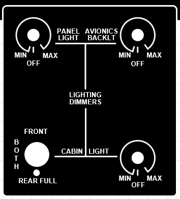

good question to consider, it's in a center overhead console and I guess 90 of the time the switch would be in the center position (dimmer for both), the rear position (light rear only is out of my view for ground operation) the front would be if the rear passengers are asleep.
[img]cid:part1.WgbUp0k8.XoPxwv9x(at)gmx.net[/img]
So I would estimate the switch itself will be operated not to many times. But your question might lead me just to a 4th dimmer for rear only and maybe even positioned so the rear pax can handle it themself.

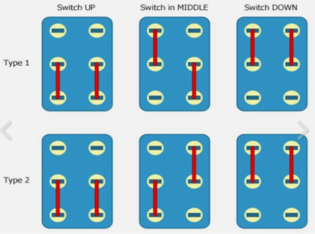

[img]cid:part1.qand01en.SKawBNOz(at)gmx.net[/img]
it's always a set of 2 closed so eg. if you feed from 5 and 2 you could do 5-4 up, 5-6 middle but then down you would have 2-3 but 5-6 would be closed as well Sad

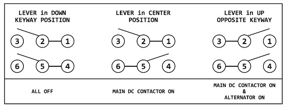

[img]cid:ii_lpo7ldww1[/img]
Take at the functions. It appears to me this is what you want.

Thanks Christopher,
but they do not work as they have not 3 independent position
[img]cid:ii_18c2b25c54dcc363cd1[/img]

Christopher, that is the same as below, due to 2 feeds it does not work
Cheers Werner
[img]cid:part2.iTW4m0cB.8H2z0xo3(at)gmx.net[/img]

Thanks Christopher,

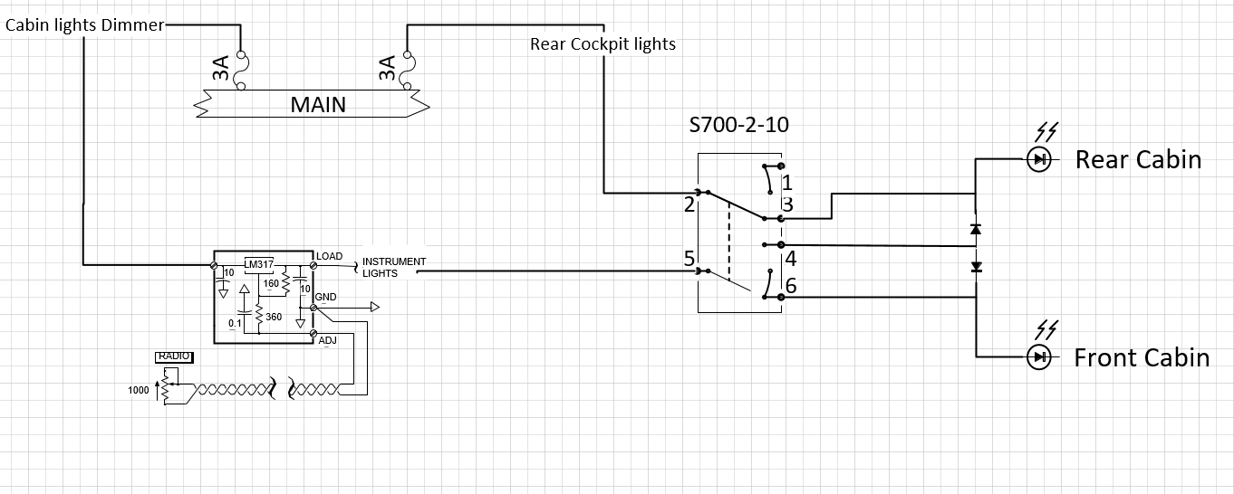

That looks like it should work.
I'd pull the feed for switch input pin2 from before the dimmer and use one fuse.
I assume there are series resistors as part of the cabin LEDs to limit current? If, not they are needed.
The LM317 dimmer circuit will not go to a completely off state.

Thanks M,
the circuit shown for the dimmer is not exactly the product used, the
Perhelion dimer has an integrated on-off switch. And the LED's are
strips with resistors for 12 V.
The problem I see is, in the position where the rear led strip is on
full voltage via pin 2, the front is as well on the dimmer, that is not
what I want. so that position is not independent. I would like to have 3
independent switch position.
Cheers Werner

[quote] That looks like it should work.
one fuse.

Thanks Christopher,

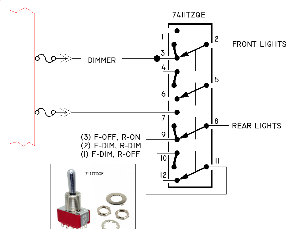

It looks like you need a DP3T switch. Do a search for them. It seems that it is a 4PDT switch with a jumper. You can search for those also.
The selection seems to be limited. There are several with PC pins and some expensive ones with screw terminals.
I've never used one. They have 12 terminals on the back of the switch, but you don't need any diodes.
See the last page on the attached; it shows the jumper wiring.

PostPosted: Mon Dec 04, 2023 9:33 am    Post subject: 3 stage switching for lights Reply with quote
This may be an option:
This switch has a 'standard' bat-handle and
mounts in the legacy 15/32 hole but has
miniature works on the back. It has enough
poles of specialty operations to get the
functionality you describe.
Not nearly so pricey as it's full-size
cousins.
https://tinyurl.com/ylf6k7gc

Thanks Bob,
with the 5A rating that switch has enough "OOMPS" and will perfectly fit my needs Smile))
appreciated!
Werner
   cousins.
https://tinyurl.com/64y4ar53

Hello Mike,
I have found the following information very helpful in designing unusual toggle switch wiring configurations, which seems to be your case.
Go to Bob's AeroElectric Connection book, Page EX11-2.
Or, use this link on the B&C website: AeroElectric Connection - "Switch Ratings, What's It All Mean?":
https://bandc.com/wp-content/uploads/2018/05/aec_switch_ratings.pdf
There are the pole diagrams for the different toggle switch configurations available through B&C.
One of these might work for you.
Good Luck,
Chuck
werner schneider
Joined: 24 May 2021
Posts: 62
PostPosted: Tue Dec 05, 2023 7:07 am    Post subject: 3 stage switching for lights Reply with quote
Thanks Chuck,
I did that beforehand, however it needs some bridging of some contacts
to achieve what I need, Bob's link did provide that information.
Cheers Werner

On 04.12.2023 16:29, M Wilson wrote:
[quote] It looks like you need a DP3T switch.  Do a search for them.  It seems
On Sunday, December 3, 2023 at 03:58:08 PM CST, Werner Schneider
<glastar(at)gmx.net> wrote:
Thanks M,
not what I want. so that position is not independent. I would like to
have 3 independent switch position.
Cheers Werner
one fuse.

On Sat, Dec 2, 2023 at 7:26 AM Werner Schneider <glastar(at)gmx.net
<mailto:glastar(at)gmx.net>> wrote:
Thanks Christopher,
