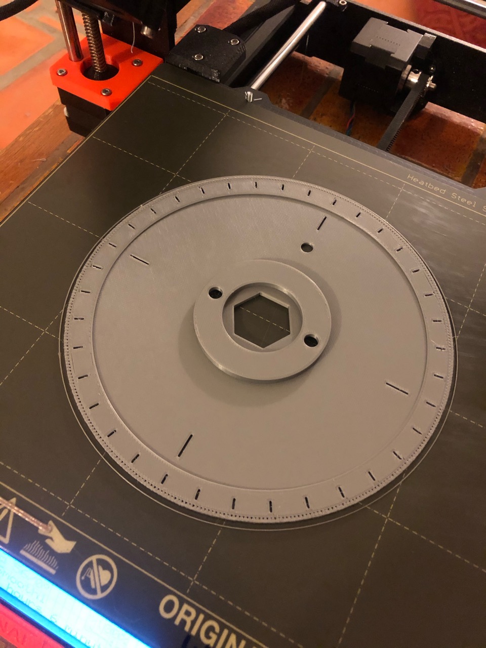

Need to fashion a piston stop; assuming it measures at 1/2 stroke position. Can anybody confirm this?
PLA Timing Wheel Printed
 Filesize:  240.23 KB
 Viewed:  7777 Time(s)

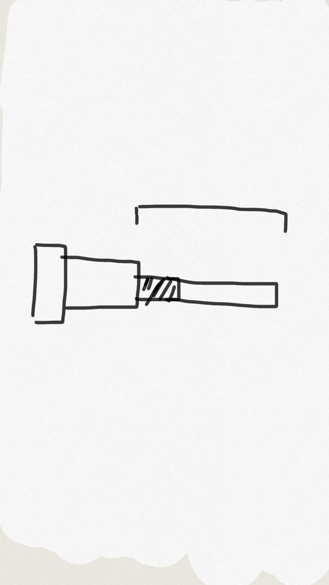

Can you tell me the length from the shoulder that butts up against the cylinder head when screwed in... or is that what you mean by "bottom of the threads"? thanks
 Filesize:  86.3 KB

PostPosted: Mon Aug 14, 2023 5:22 pm    Post subject: Re: Rotax Piston Stop Tool Reply with quote
The dimension you’re asking for with your sketch is 5.75 cm.

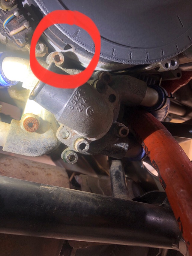

Used dial gauge to identify TDC; can use a machine feature of the dynamo bell and top water pump bolt as a position marker.
The unique machine feature of the dynamo bell lining up with top M6 water pump cap screw marking TDC

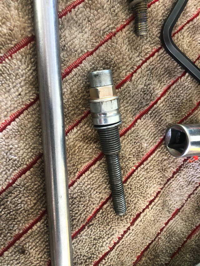

Piston Stop Crank Alignment Tool
 Filesize:  268.67 KB
 Viewed:  7718 Time(s)

The piston stop tool worked great; thanks Jim! The tool was made from a new spark plug turned down in a lathe, the porcelain core was knocked out and an M8 tap chased through. The pin was an M8 cap screw that had its thread chased all the way to the head and the the other side turned into a ball end with a locking nut added to finish it off; all worked perfectly.
Checking the crankshaft phase was relatively easy with the timing wheel located on the back of the crankshaft. Removal of the black plastic dynamo cover was required first, and the timing wheel just pushed tightly onto the 23mm bolt head.
Piston position that the piston stop affects is 65deg BTDC; which will likely be the fastest sector of piston stroke. So any deviation in crankshaft phasing will show up the most here.
