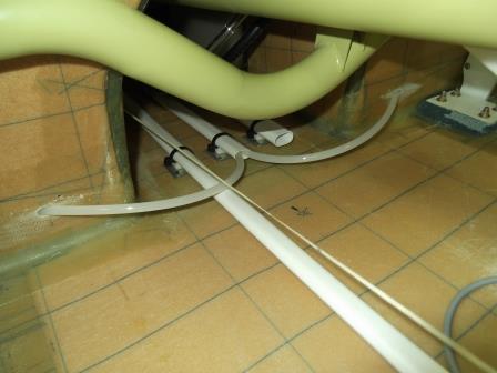

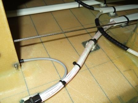

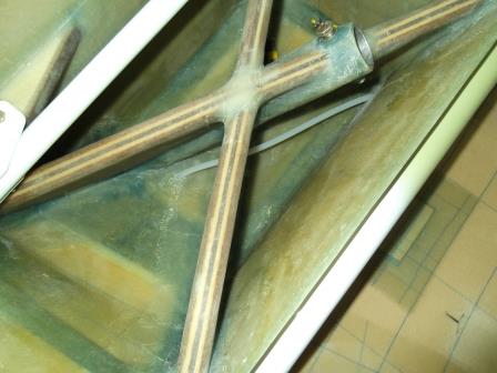

PostPosted: Sat May 20, 2023 9:10 am    Post subject: Re: Brake Line Routing TG Reply with quote
Hi Kyle
A couple of pics of my installation. I think you have it spot on.
I added some spiral wrap later to protect from chafing between the pipe, the rudder cables and wiring.
 Filesize:  51.06 KB
 Viewed:  5004 Time(s)
 Filesize:  55.27 KB
 Filesize:  54.03 KB

PostPosted: Sat May 20, 2023 12:26 pm    Post subject: Re: Brake Line Routing TG Reply with quote
Hi Kyle
Yes, oval PVC electrical conduit. Very thin wall - the type you bury in plastered walls.
I secured at the back of the wheel well and aft of the baggage bay. I used one for the brake pipes, one for wiring and one for the radio antenna cable. Keeps everything safe and secure through the tunnel and under the tank which otherwise would be a pain to get access to.
The antenna conduit runs all the way to the rear bulkhead so installing the antenna cable was really easy and will be easy to replace if needed in the future.
Kelv Weston
