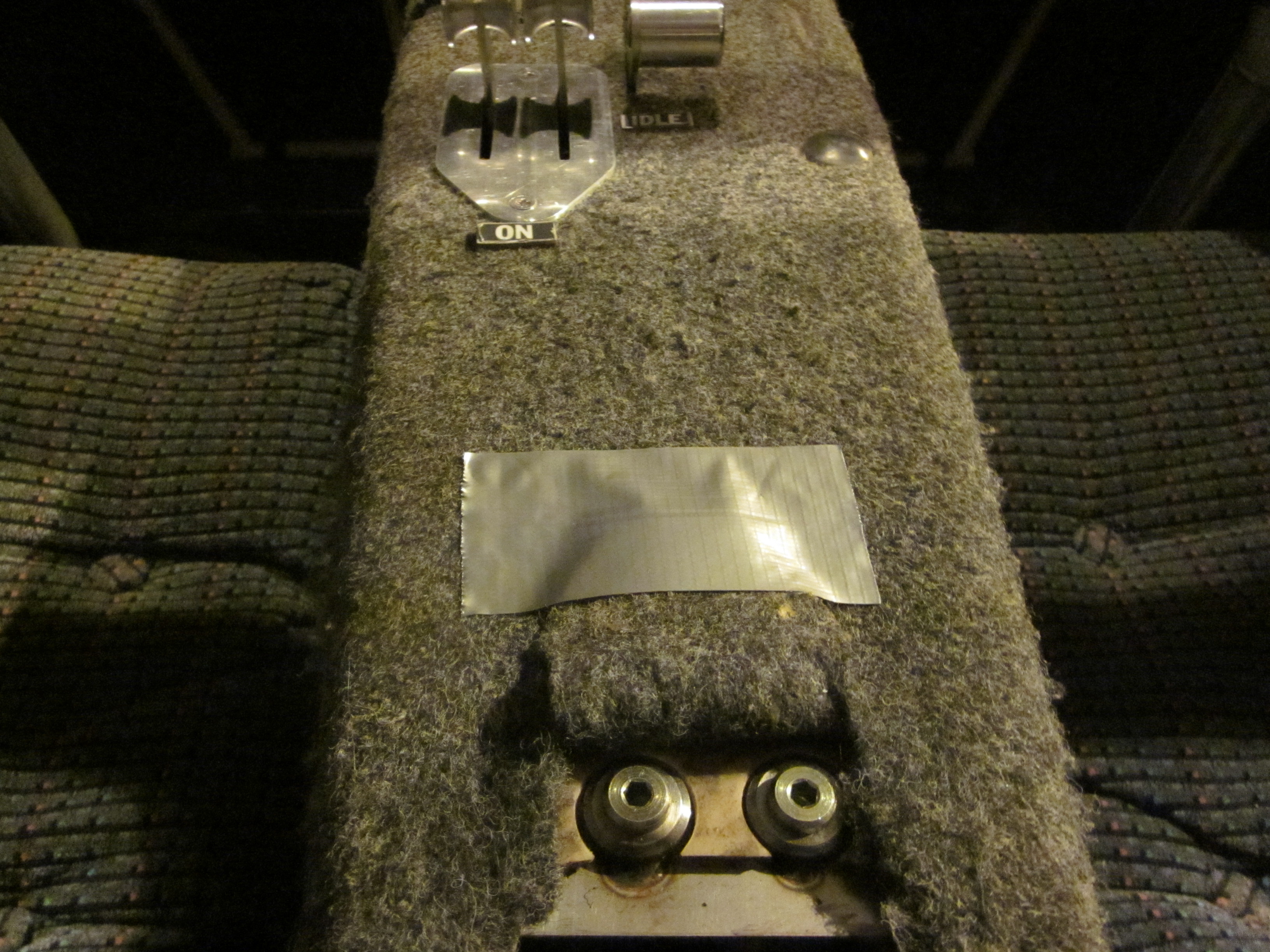

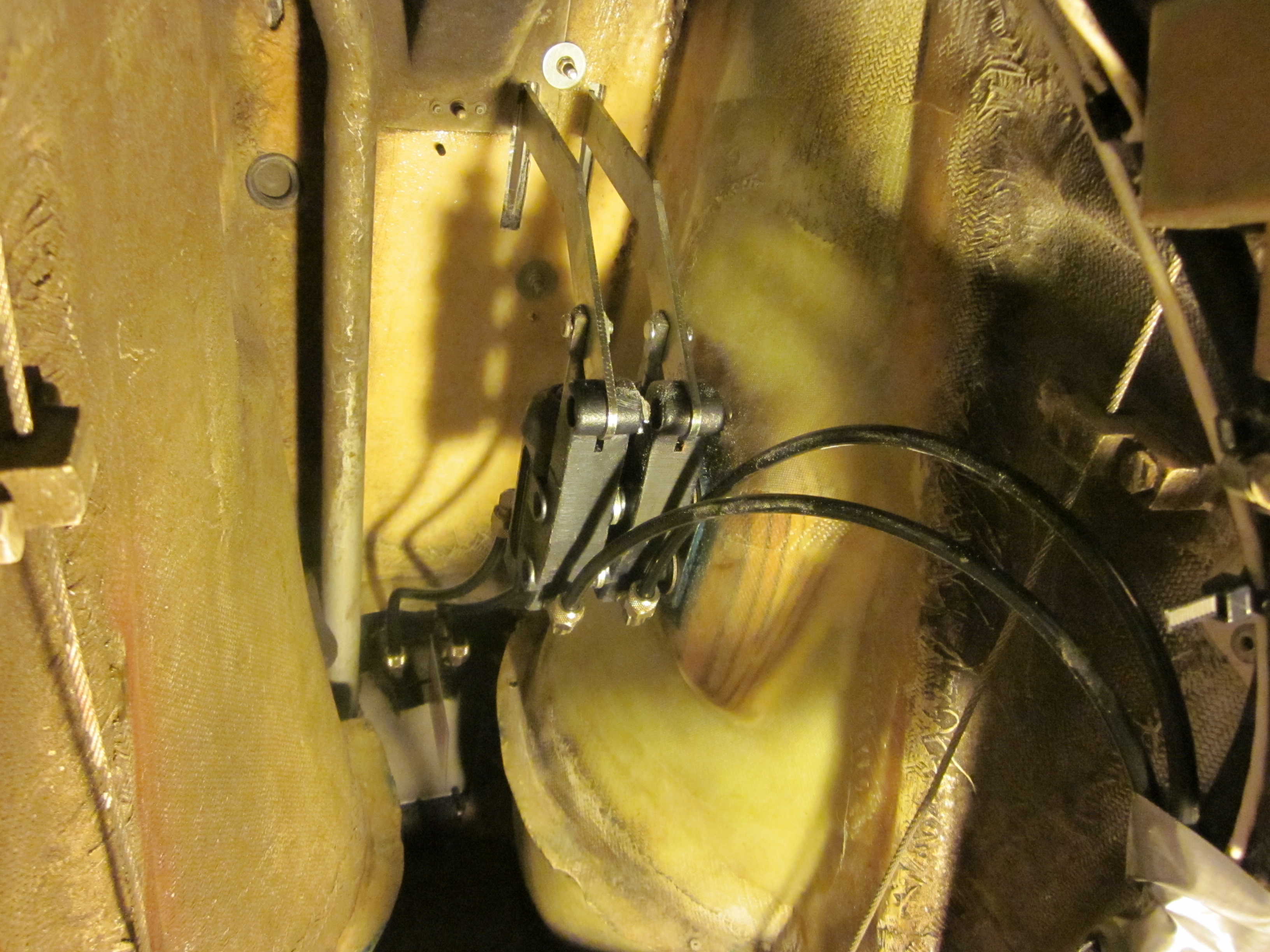

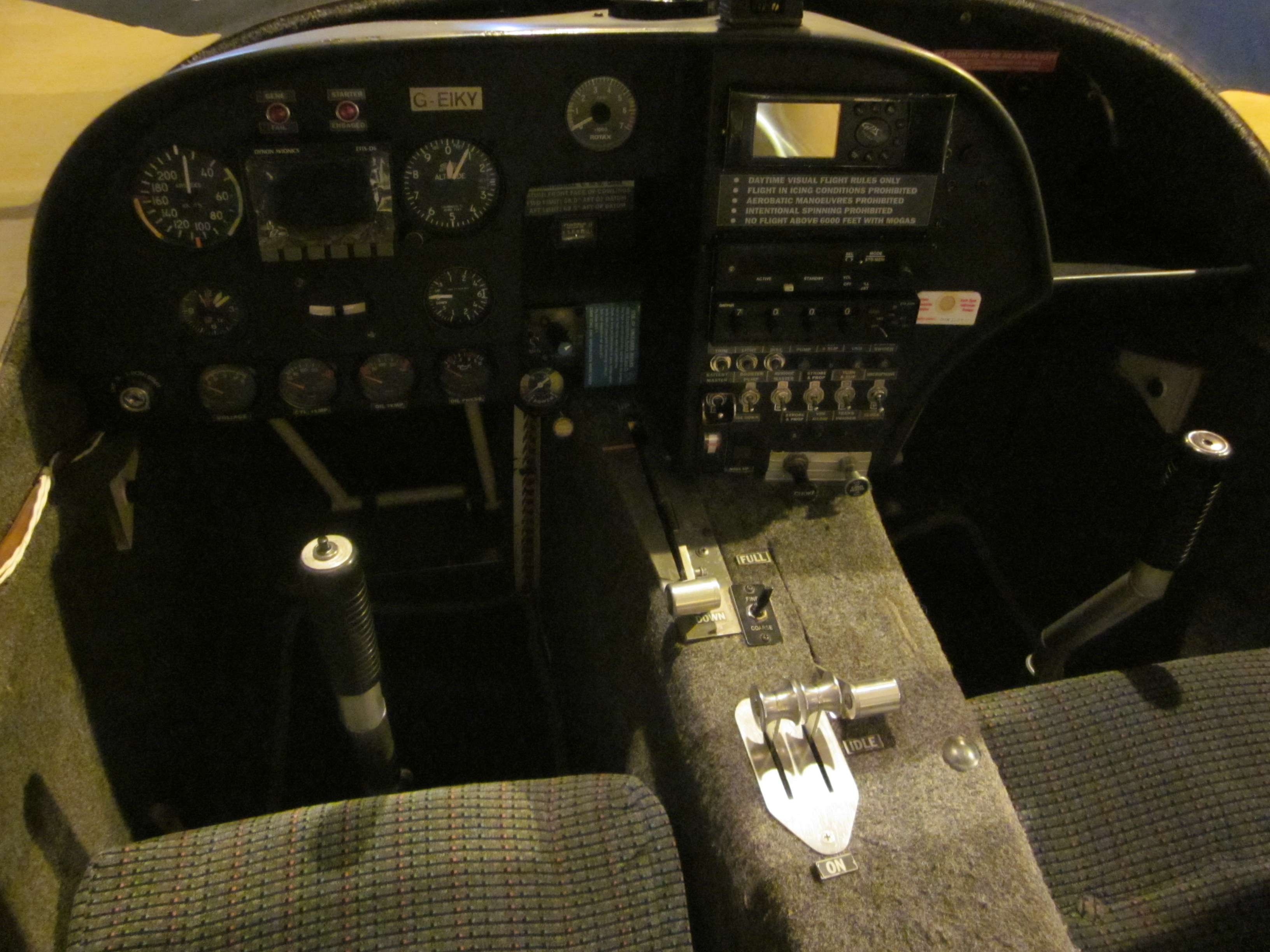

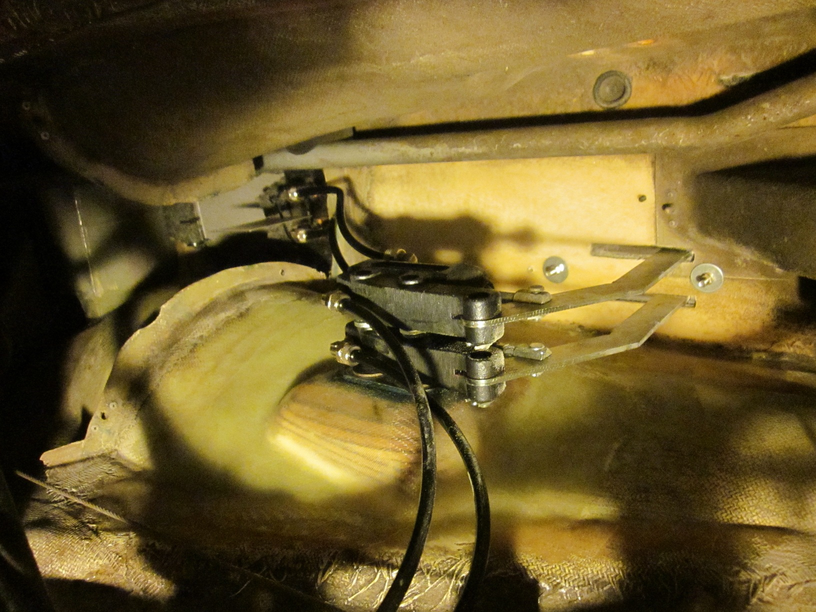

Mine has no separate reservoir, only the master cylinders for finger brakes mounted inside the tunnel. See attached pictures.
