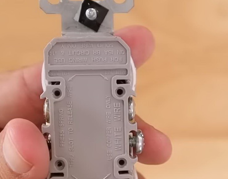

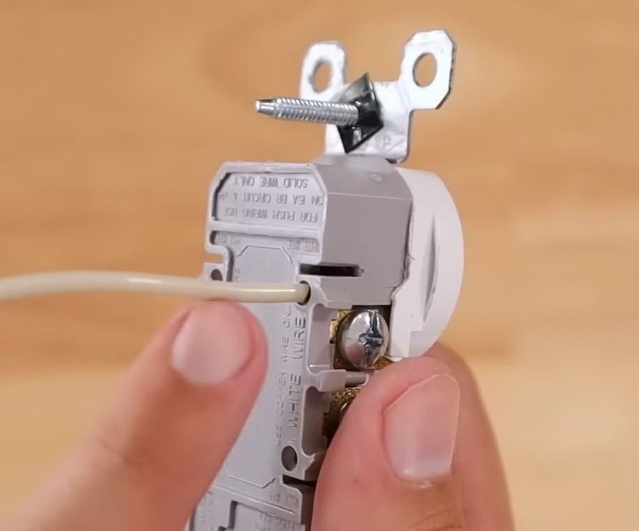

I often learn of new techniques here, and don't like
to miss out on safe, convenient alternatives.
I've exploited the convenience of the WAGO
style connectors (of which there are many
examples out there). But only on relatively
low current house and appliance wiring.
Lighting branches, ceiling fans, etc. but
never where there's a risk of moisture/condensation
ingress.
That same spring-barb, high-pressure
connection has been around for decades.
First recall seeing it in strip-n-poke
termination on wall receptacles and switches.
In years since, I think I've seen the same
technology on other small wiring components.
It's noteworthy that the entry hole in
receptacles will only permit termination of
14awg wire . . . 12AWG wire won't go in.
