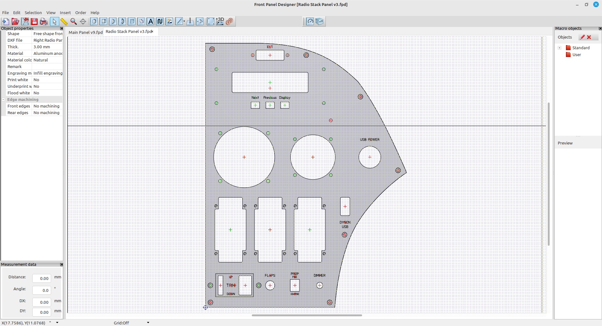

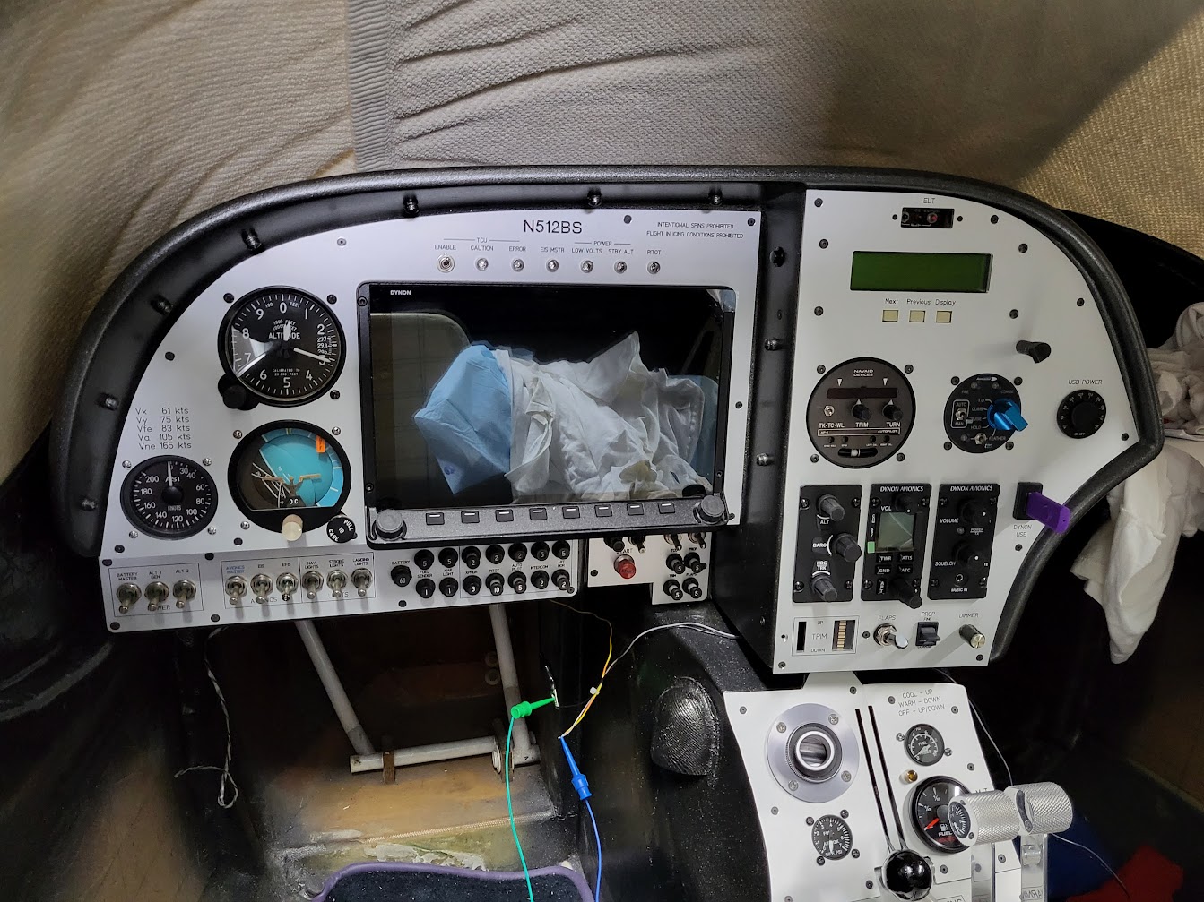

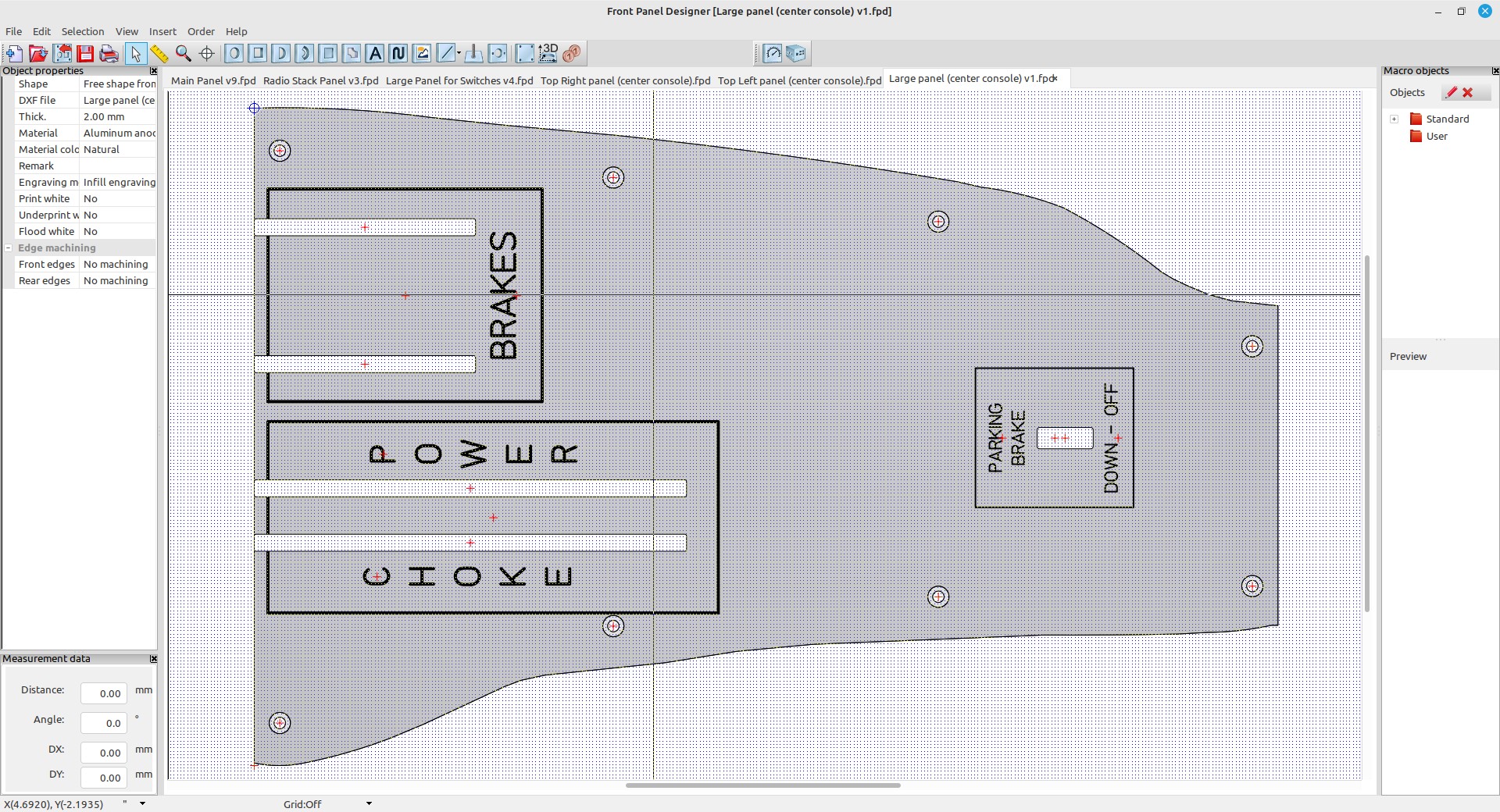

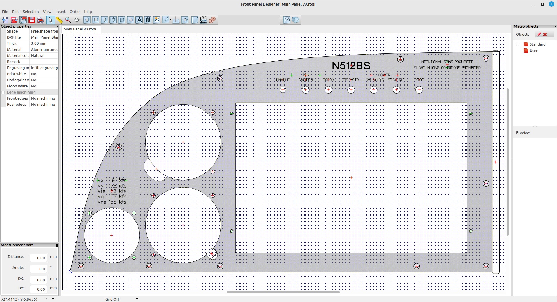

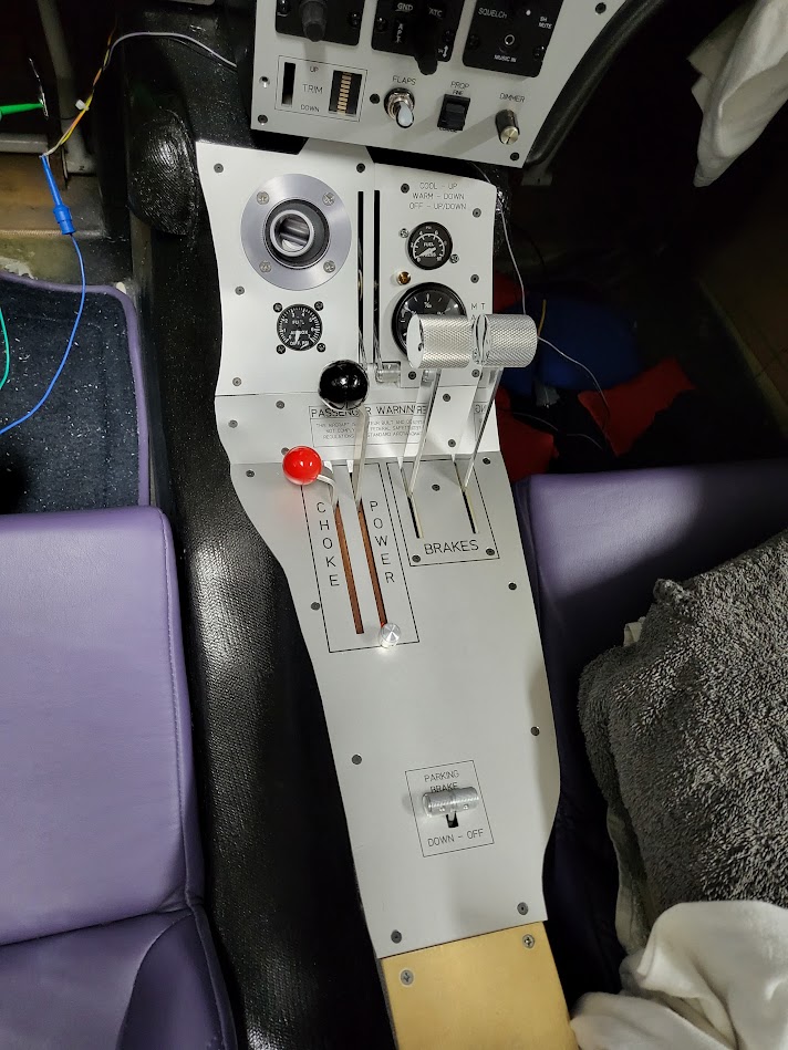

For my panel, I used Front Panel Designer. They have a great free design tool and create/ship the panels fairly quick in the US. The hard part was getting the panel outlines into CAD to start. From there, it was actually kinda fun with their design tool. The cost was between $50 and $175 depending on the thickness and complexity (2mm or 3mm). Let me know if anyone wants the CAD or Front Panel Designer files.

Looks great! 👏👏👏👍
Yes lots of fun getting those profile lines correct 😂😂😂
