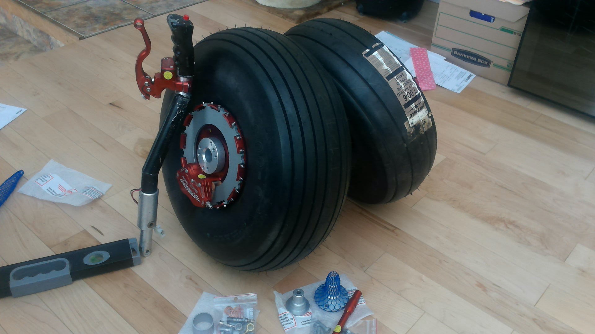

Jerry the photos of the Beringer wheel & brake were posted 8/15 2022 but they are to be found in the 8/12...2022 " what did you do with your Europa last week".
I chose the Airtrac 800-6, here is a photo of the Beringer with 800-6 beside a 700-6.
The 700-6 is 0.7 lbs lighter and 1/2" shorter and 1" narrower. The total weight of the wheel and brake with 800-6 Airtrac is 19.99 lbs. or 9.07 Kg, take your pick.
