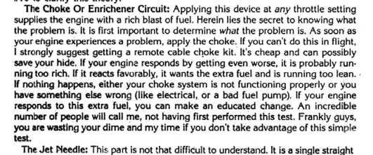

PostPosted: Tue Jan 24, 2023 8:19 pm    Post subject: Re: Carbs - enrichener - cold start. Reply with quote
Copied & pasted from the CPS tech articles page:
This is why - when the gasket at the bottom of the plunger that sits on the bypass was damaged - we could not get the carb on the 277 properly jetted.
Yes, the throttle slide has to be all the way down to generate enough vacuum for the enrichner to work when starting.
However, once the engine is running, then there is enough vacuum throughout the carb to constantly suck fuel through the enrichner bypass if the plunger is not sealing it off for whatever reason.
 Filesize:  79.61 KB
 Viewed:  15517 Time(s)
