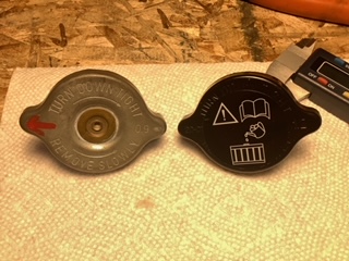

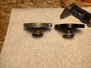

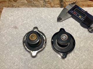

Indeed the triumph cap p/n T2108005 does indeed fit, with very close, but not exact dimensions to the stocker, and tested to release around 1.1bar using an inexpensive tester.
The housing is of thinner material, but still adequate. The outer seal is actually floating on a “bearing” eliminating the sliding friction when installing compared to the original. Overall it appears to be higher quality.
Btw, when tested, my original cap was found to be leaking - so i was running at ambiant pressure explaining my blow-off.
