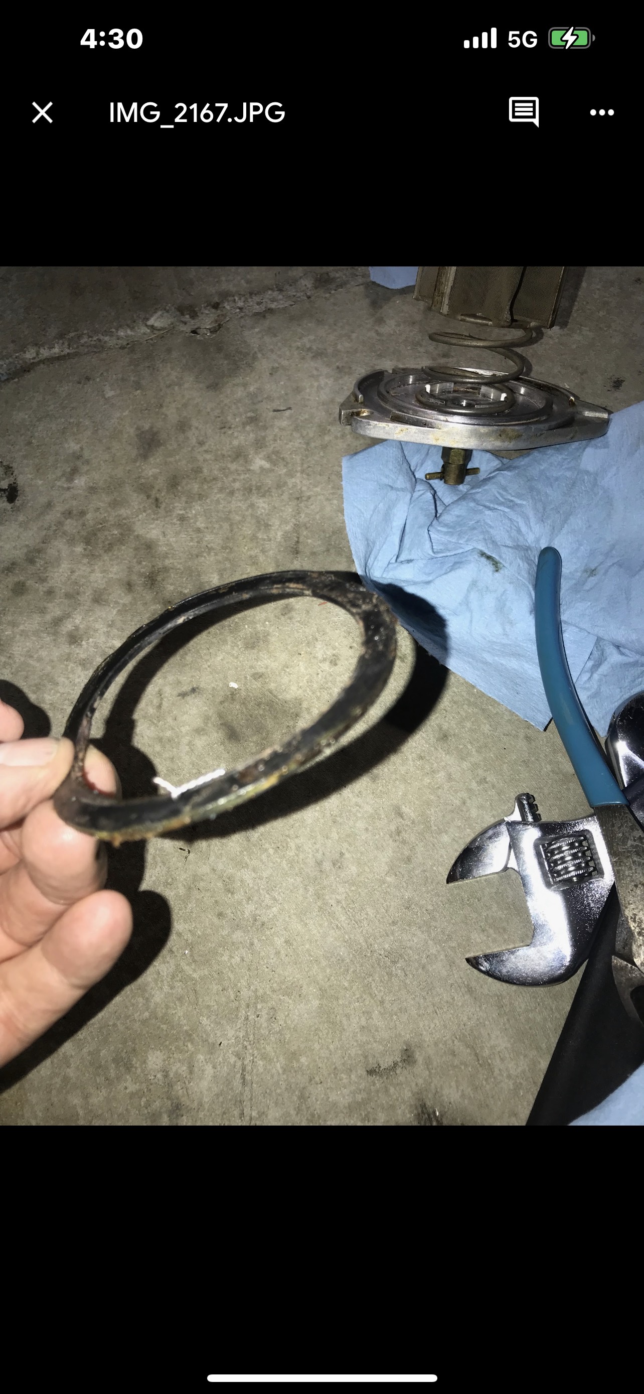

Jon
You are correct there is a round gasket in the bottom of the consumption tank.  When I went through mine I got a new one from Doug.
I would reach out to Carl who has the parts business now.  I am sure be has one.   If not you cut one from any suitable material for AV gas.
I put a photo of my old one as I removed it from the tank.  You can download it and blow it up to see the thickness. It is pretty thick.
Mark Pennington
N621CJ
[img]cid:185afa1e290c47b222f1[/img]

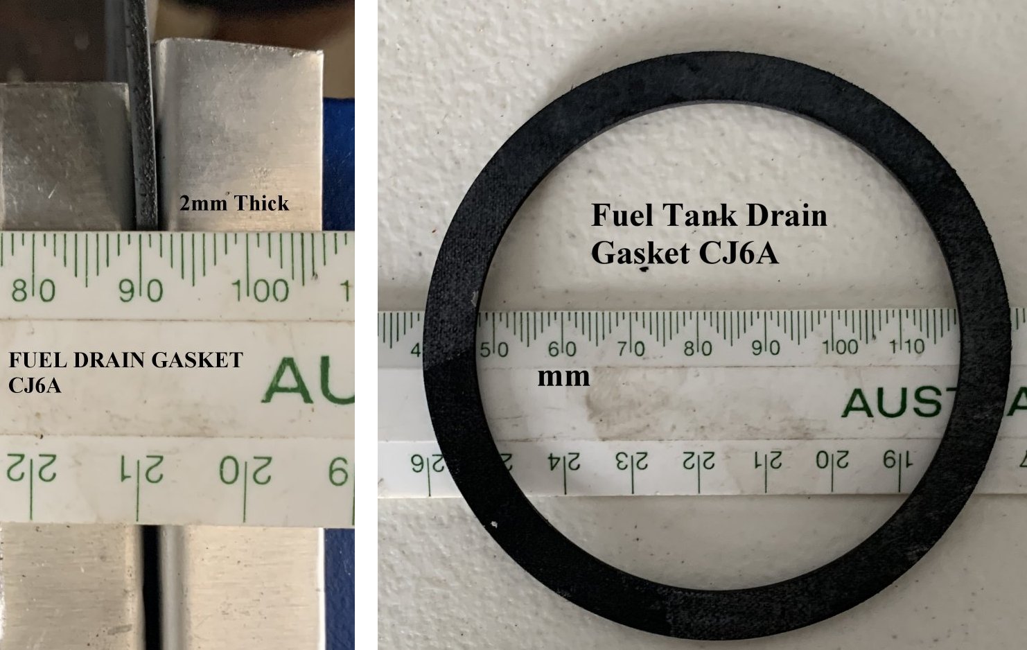

Another view.
I got one of these gaskets from Doug a while ago. Yet to be installed. Next visit to the hangar I will measure it.

Images of a new Fuel tank Drain gasket.
