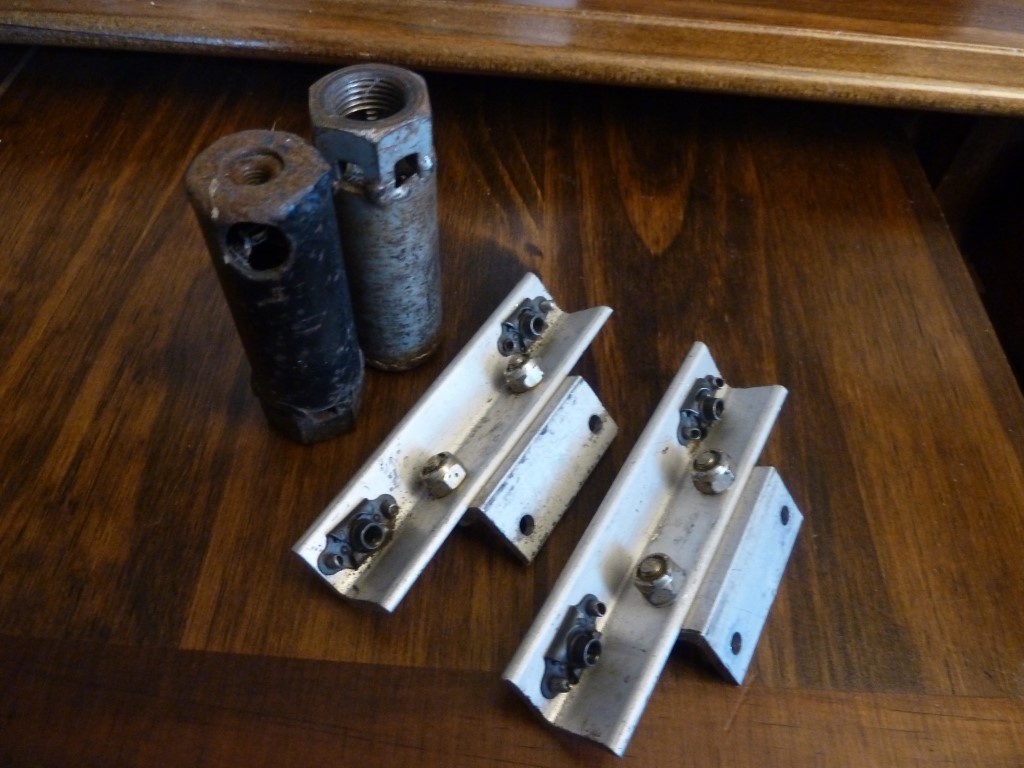

Jaydub said: (Quote) I saw in the plans there is a special nut/spacer to use with wheel pants. Where is that part available? I don't know much about putting wheel pants on a Kolb so I'm asking for advice. (End quote)
I am 99% sure this is what you are referring to. They replace the standard axle nuts and extend out to the outside inner part of the wheelpant, and are threaded for a 1/4" screw/bolt.
Verify that your axle thread on your KXP is the same as the MKIII (which is what these are off of - I made them for my MKIII about 26 years ago) and they will likely fit, depending on the width of your wheel pants. You can always add a spacer if necessary.
Yours free plus a few bucks for shipping. PM me your address once you are sure they will work.
Check out the link here for how I mounted the wheel pants on my MKIII:
http://oh2fly.net/oldpoops/pg6.htm
I may still have those mounting brackets somewhere, if I can find them and you want them, you can have them too.

Posts: 1671
PostPosted: Wed Dec 21, 2022 12:41 pm    Post subject: Re: wheel pant options for Firestar Reply with quote
Found the brackets if you want them too.
